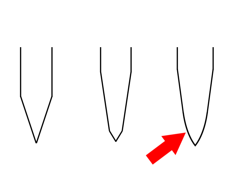

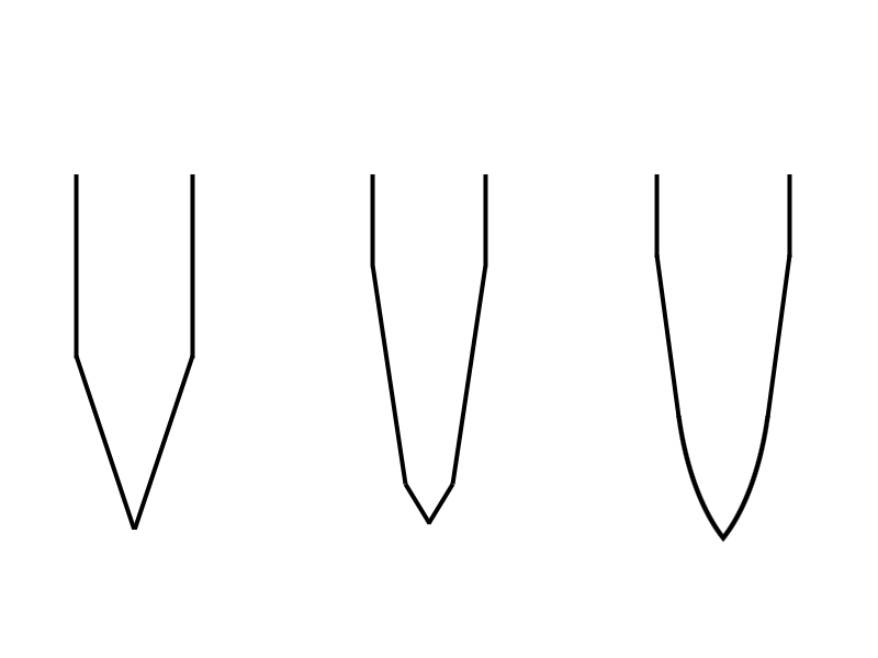

First, you decide what you want. A flat V edge, or a rounded Convex edge.
In the picture below, you have three typical grinds. The first is a v type of grind in that the edgemost portion looks like a "V". Knives that just have the vertical flats and a large v grind are "scandi" knives. We don't really deal with those much in terms of Becker knives, but it is useful to know they exist.

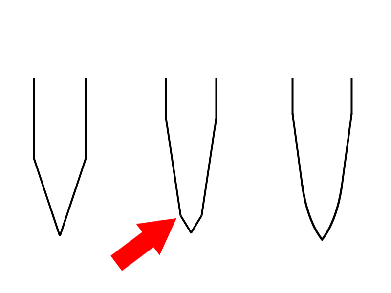

The middle design has a double bevel, so a flat vertical portion, then a long primary grind, then a short secondary grind. The transition between the primary and the secondary bevels is known as the shoulder. This comes into play here because most of the Becker knives have this style of grind, which, if you look at the edgemost portion, is also a v-grind.
The right shows a convexed shoulder, or what you can turn the middle one into with a little bit of work removing the sharp transition between the primary and secondary grinds. A full convex would be a smooth continuous curve from edge to spine that would mimic the shapes shown in an abstract way, but as it is incredibly difficult to manage to do with a Becker knife since we already have a flat then other bevels ground into the blade, we primarily concern ourselves with the middle or right designs as they are both easily achieved and maintained on a Becker knife.
So, the first question is, which do you want? The middle, or the right? Ffor most of us, it will be a choice between the middle, or the right.

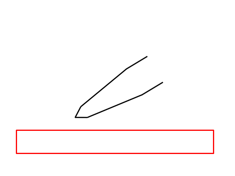

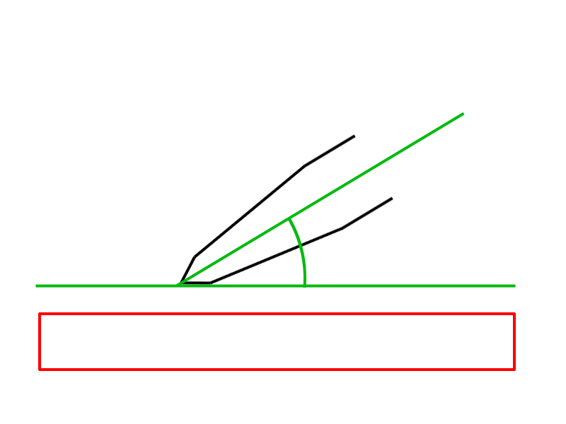

With any type of v-grind edge, your goal is to refine the secondary bevel to an apex between each side, typically at an angle such that it is "sharp". This is done by refining the faces of the secondary bevel, usually on a stone or other flat surface (ceramic plate, diamond plate, etc...).

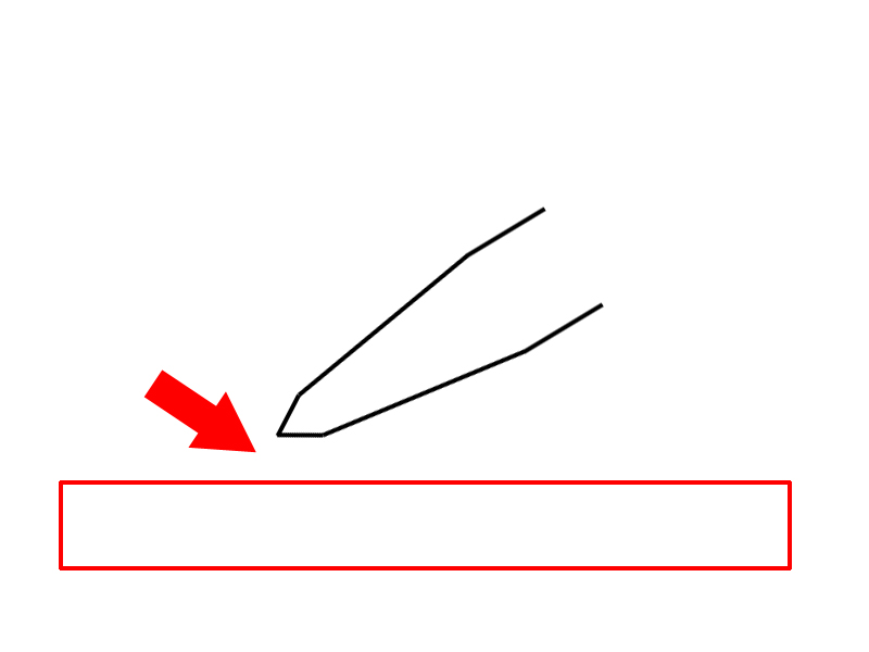

To sharpen this, we mate the flat part of the secondary bevel to the stone.
These parts meeting up will refine the face of the secondary bevel, and as you alternate between sides, will refine the apex, or very tip where the faces meet, thus creating a sharp edge.
When sharpening on a stone I find it easier to cut into the stone as this leaves less chance for a "burr" to form, and also leaves only one direction of scratches to remove as you continually sharpen the blade.
Now, imagine a line drawn through the center of the blade from the edge through the spine. The angle at which the secondary bevel face meets the stone is the angle at which you are sharpening your knife. 20 degrees, 15, 17, etc... are all fairly common, but the angle choice ultimately ends up being up to you. The bigger the number, the bigger and more robust of an edge you are going to have. More material equals more stronger and thicker edge angles make for more material. However, too thick means they don't get as sharp, and in turn do not cut as well.
So given everything we have shown thus far, for a v-grind style of edge, the only thing you have to do is to refine the faces of the secondary bevel. That's it. This is achieved by running that face along a sharpening stone of some sort. You can go crazy with it, going through grits until you get a ridiculously sharp surface, or even a mirror polished surface, but ultimately all you are doing is refining the face against a solid surface until the apex between sides is sharp enough for what you want. This means that if you find something flat, and hard enough to abrade the steel you have in your knife, you can sharpen your knife on it. If it has a flat plane in at least one direction, it will work. This is how people are able to sharpen a knife on the bottom of a coffee mug, or the edge of a car window, or a rock they find in the woods.

Moving on, now we tackle my preferred style and that is the mythical "convex".

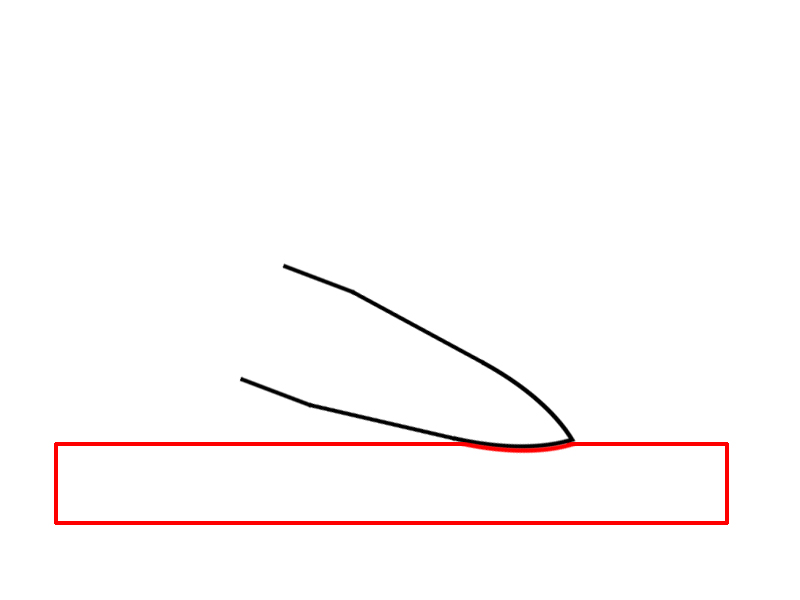

Convexing a knife refers to relieving the transition between the primary and secondary grind or the "shoulder". (At least in terms of Becker knives. You could take convex to the extreme and convex it completely, but that is beyond what most of us really want or need in a production knife, and as such while it is possible, it is not done that often, and almost never without the benefit of a belt grinder.)
Convexing is vastly different than from sharpening a v-grind because it is even more variables. You have a curve, and a curve is not an easily measurable thing in the edge of a knife. Mostly though, convexing is in many ways an art rather than a science.
The benefits of this method are that it is very forgiving as all that it requires is smoothing that transition. Getting a Becker knife to this point is simple, and requires very little in the way of tools or equipment. I personally use a cheap nail file to remove this bevel, as shown in this thread here: http://www.bladeforums.com/forums/s...tory-edge-to-convex-with-the-BK2-(and-others)

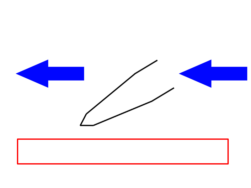

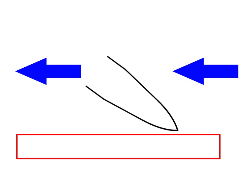

So how does one strop a knife? Well first you pull the edge away from the strop, like so:
As you pull away, the strop material will abrade the curved face, towards the apex, and thus a sharp knife is created. By going through multiple levels of stropping, you will refine that edge further and further, getting you closer to what you will consider "sharp enough".

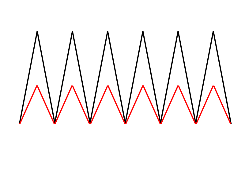

Sharpening does some interesting things to the edge of your knife though. By default, most Becker knives come with a 180 grit edge on them, and that is pretty rough, although definitely useable. As you progress in sharpening you will take it through higher and higher grits, thus refining the edge, but also refining the "teeth" that are formed as material is removed.
As shown in the image above, you will have something like the black lines with a rougher grit, and something like the red lines with a finer grit. This varies in shape and size a little bit but the illustration shows what is happening as you refine that edge on a microscopic level. Thus when you hear people refer to an edge as "toothy" you can imagine that it has longer teeth, which in turn is less refined than a smoother edge. For some, a toothy edge given from a strop with black compound is more than enough to do whatever they need to do with it. FOr others, they want the edge as refined as possible, and end up with super mirror polished edges. Whatever you choose, keep in mind there is no right or wrong end result in terms of grit, shininess, or anything else.
Let's look at the physical act of stropping the knife. The teeth shown above are formed when you pull the knife edge along the strop, and you have to be careful to align those teeth in a certain way to generate an edge that will cut the way you want. I like the middle ground, I want my knife to work well in a push cut or a pull cut, so I alternate my stropping to achieve these.

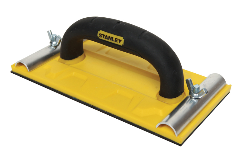

Tradewater showed us awhile back the method of using a drywall sander pad as a backing, then using automotive wet/dry sandpaper for the abrasive.
It has a hard flat backing, a foam pad to create give, and you can attach as fine a grit of wet/dry sandpaper as you want to pick your grit. Works great, costs very little, and is fairly safe given that it has a handle on the backside.
Nail files work too, as they are a known grit of sandpaper attached to a foam core with plastic backing. Cheap too. Great as field "strops" and easily replaced, and very easy to get ahold of.
