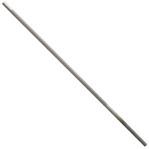

Aluminum Rods:
Sizes of round rod are 1/4”, 5/16”, 3/8”, ½”, and 5/8”. There is an additional ½” square rod used for small and V shaped serrations. I order the rods precut at 8”. The 1” ends of each rod are reduced by lathe or grinder to ¼” diameter in order to fit into the chuck and the drill extension. This leaves a 6” workable area in the center of the rod to stick on your abrasive of choice. I use 6061 Aluminum which is a marine grade, corrosion resistant, and cold workable aluminum.
I get my rods from Speedy Metals because the prices are low, there is no minimum order, and they cut the rods to the sizes I specify. It’s a good place to get new stone blanks cheaper too. Wherever you choose to buy metals, don’t get it at your local home improvement store. The type of aluminum or steel is typically unknown. Plus, the metal will be soft and usually not straight.
Note: buying rods smaller than ¼” really requires one to use properly hardened steel rather than aluminum. However it’s rare that you would need rods that small. When I do, I just use the smooth portion of an appropriately sized chainsaw sharpening file.
