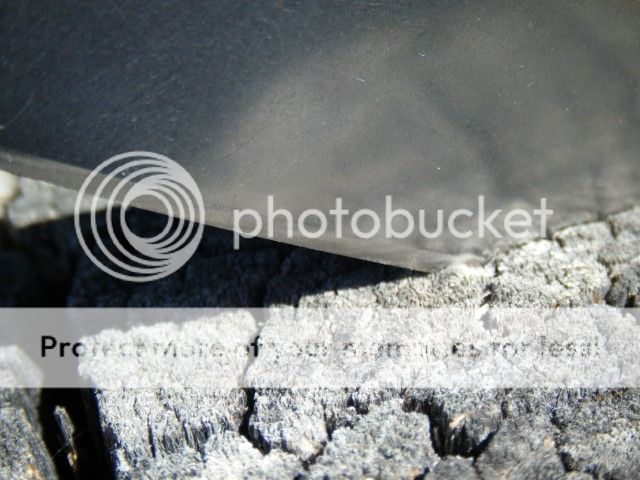

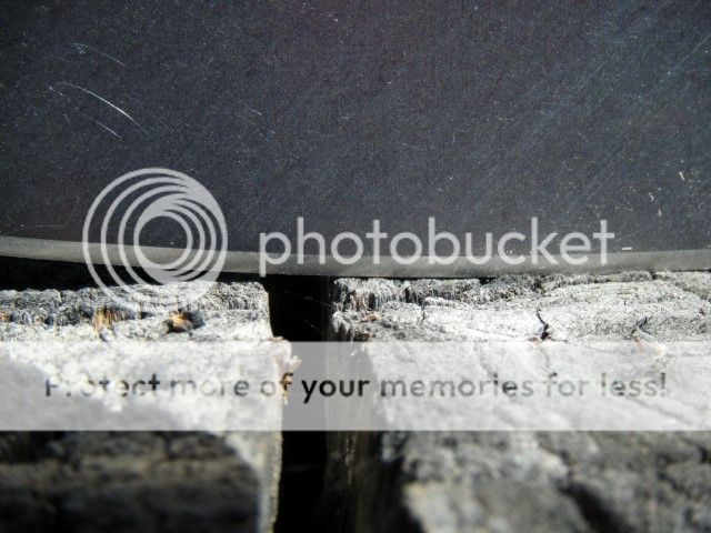

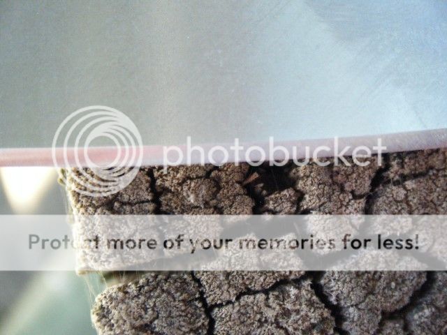

There are a few ways to sharpen your Sebenza. While away from home, here is my kit on my 2010 Insingo and it has seen quite a bit of use and lowering of the edge angle:
[video=youtube;XWE14n6-8MU]http://www.youtube.com/watch?v=XWE14n6-8MU[/video]
Here are pictures. As you can see, one can not even see the micro bevel applied with the UF Sharpmaker stone.

My small Insingo has been my EDC for a while now. I did find that the 40 degree setting on my Sharpmaker was not very effective. I ended up reprofiling at ~30 degrees on my Edge Pro and now use my Sharpmaker to maintain a micro-bevel. I use it all the time but do not let it become overly dull. Makes for touch-ups on the fine stones very quick since the micro-bevel is so small. I also will strop it if the edge is in good shape.
