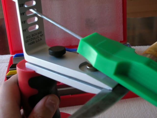

Although I use a Lansky I have used a Gatco in the past. The advantage the Gatco has is that the stones are wider and (imho) more comfortable.
GAtco has a better guide system, since it has more angle options than the lansky. But the lansky has better stones, and they are thin enough to sharpen recurves . So the best is a gatco guide and stand with lansky stones. IMHO!
i dont care for the lansky or really any other system which requires ya to clamp something on the blade.

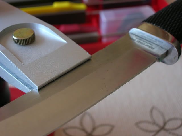

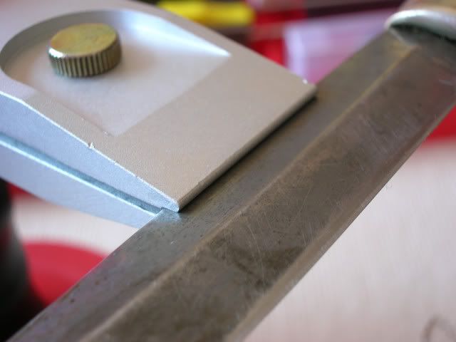

Grapevine said:If a blade is wider that angle is going to be shallower because the edge is farther out. Also as you do the "w" strokes they suggest, the strokes on the outside where it's angled away will be at a shallower angle.
if ya put some masking tape on the blade and are carefull when ya tighten the clamp down ya can keep it from scuffing it, or it wont be near as bad anyway.
With the Gatco and Lansky you're actually not sure what angle you're getting, though that may not matter if you're getting it consistent for each knife. If a blade is wider that angle is going to be shallower because the edge is farther out. ....
