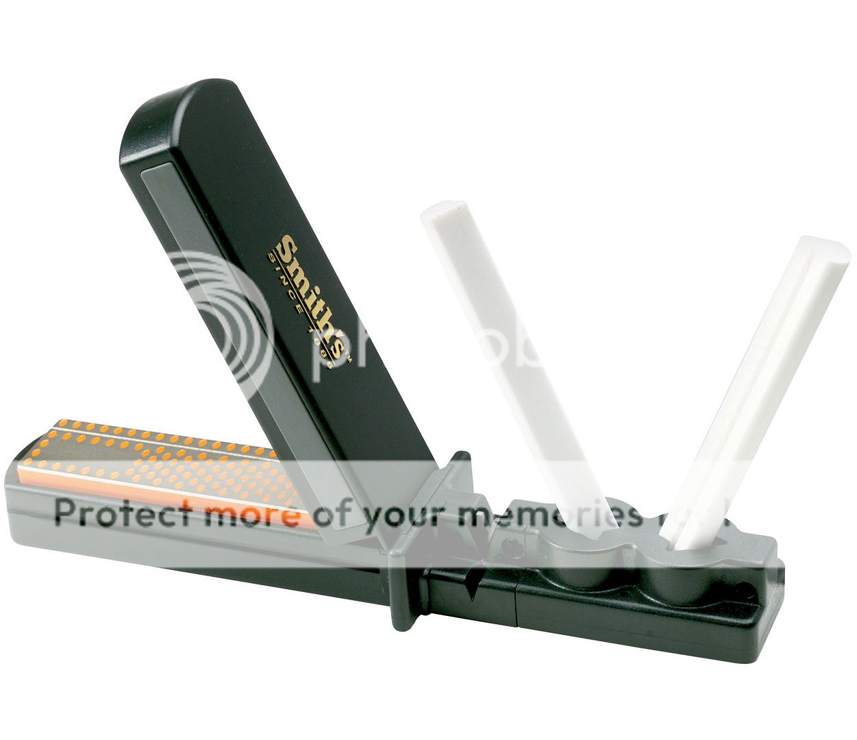

I am using Smith's 3 in 1 Sharpener, and it seems as though I can get a nice edge on my blades (enough to shave with), but I know it could be better! There are only two "grits" in the system: their diamond stone and their ceramic V rods:
But it feels like I'm missing something! I'm not completely satisfied with my edges.. Is there another stone I could (or rather, should) get to compliment this simple system?
Also, how will I know when the diamond stone is wearing out? After just a few knives, it already seems smoother than it was

I cant comment on the quality of this one as i never used it but most diamond sharpeners have a break in period until they stabilize for a long time, assuming you dont use too much pressure.
Have you tried to strop your edge afterward ? It does help a lot cleaning the apex after stone work.
Besides the carbide scraper and the wide fixed angle of the ceramic rods, it looks like a pretty good sharpening tool. If you want something to complement the Smith's sharpener then I'd say to try stropping on compound and/or pick up a coarse stone (Norton Crystolon, India, or coarse DMT).
Yeah i noticed the carbide scraper too but i assumed OP didnt use it as he didnt mentioned it, otherwise this stuff looks okay.
Whats the angle set up on these crock sticks ?
I don't use the carbide scrapers unless it's a terribly chipped or flat edge. I'm not sure on the angle, I think I've heard it's 23. I've been thinking about getting the "Lansky Deluxe 5-Stone Sharpening System" so I can get some precise edges and don't have to worry about keeping a steady angle - anybody know about the quality of that one?

Lansky clamp kit is quite good but kind of slow with the regular stones if you have to reprofile obtuse or badly abused blades but the results are vey consistent with a bit of learning curve.
If i were you i would go with a basic diamond set instead of the deluxe standard stones.
You may take a look at the Spyderco sharpmaker aswell, but keep in mind this one is much more about frequent touch ups than the lansky is.

Generally agree, with maybe one qualification. You could just buy one coarse/xc Lansky diamond hone to supplement the 'Deluxe' kit. Heavy grinding & reprofiling with the standard hones in that kit will be very slow on more wear-resistant steels like S30V, D2, etc., and it might also dish or otherwise wear out the standard hones. A supplementary diamond hone for the first-stage grinding would speed things up, and then the standard hones in the rest of the sequence should work well enough to further refine the edge. The Fine (600) and UF (1000) ceramic hones in the 'Deluxe' kit are excellent finishing hones, and they aren't included in the diamond kits.

If you are getting an edge that is enough to shave with, there is no "better." That's just fine. :cool: Can you get more refined or keener? Sure, but that's not "better." That's just different!

I bought one of those a couple of years ago on clearance at a local sporting goods store just for the ceramic rods. The kit as a whole makes no sense to me, with the carbide scraper, a diamond plate of 750 grit and the ceramic rods of 800 grit with a single angle option of 23 degrees. Again, I was only after the rods (4") for field kits as they are V-shaped on one side, rounded on the other and have a hook groove and I have been very pleased with those. If it had a more coarse diamond plate along with different angle options for the rods and minus the scraper they would really be on to something.
