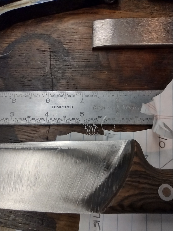

I hand grind all the knives I make.... I finish off with both.... An Atoma 1200 diamond plate, and a FortyTwoBlades FortyTwoBlades Artic Fox.

My customers (friends) here, some who have collections that rival the Smithsonian....tell be My edges are the Best, sharpest they ever got from a maker..... So. That tells me that I'm Good. The equipment I use is Good.
Just off the stone..
Those curls are tiny!
Get an Artic Fox.
I'm going to buy a backup.
Edit: you will also see in my picture, of a Gossman sharping steel. Get one of those, too.
