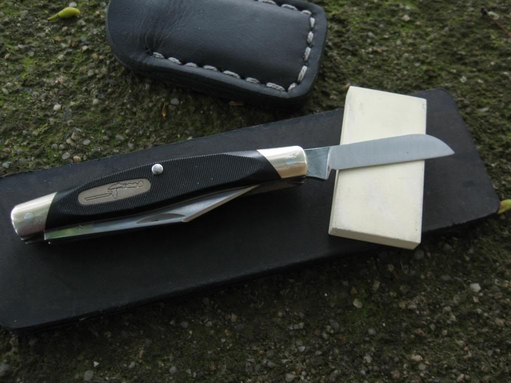

For pocket carry i use a very small yellow stone, cut down from a bigger one, it is my favorite for touch ups, and can even do some dull ones with a bit of patience. I even had another one cut a bit bigger, to replace maybe the dc3, or to keep it in another pack.
But i carry small to medium size knives. Urban carry is mostly a Case peanut, or maybe a medium stockman, and out camping and such, a fixed blade, Izula or Hest mostly.
