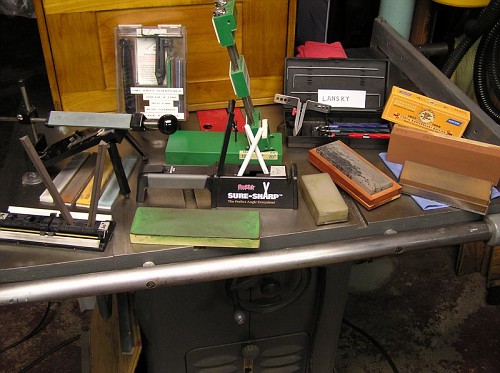

I started out with a cheap set of crock sticks and look what happened to me. This is only a small amount of the sharpening methods I use. It becomes, for some, addictive.
