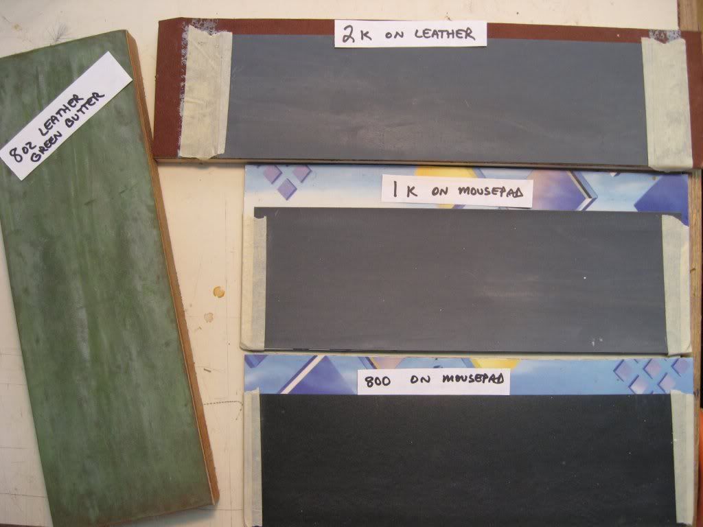

I have alot of convex-grind Bark Rivers (I want a Falknivven too!). Here's what I use. This is an old pic. I don;t use mousepads anymore. All my sandpaper "strops" are sutup like the 2000 grit strop - one grit on one side, another on the other. I have 320 and 600, 800 and 1000, and 1500 and 2000. In the last year or so, I have reached a point where I like convex sharpening better than anything else. There is less adherence to a certain angle. It's more relaxing because there's a tad less concentration involved. I don;t know if that can be misinterpreted, but convex-ground edges are just a little less demanding, I think.
If you choose to make a setup with wet/dry paper, I think you'll find, even after the roughest use (or abuse) of your Falknivven, you'll rarely need to go below 1500 grit, and I do mean rarely. In fact, most of the time with my knives, even after some heavy whittling includding chopping on mesquite, all that's required are some very light strokes on 2000 and then the CrO2 strop.

Stretch, pardon my noobness, but what is the green butter thing?

That green butter thing is 9oz leather glued to a wooden board and "buttered" with green chromium oxide. That's my strop.
That Bark River link that Rifon2 provided is a good one for starting out with convex.
I have found that I like a more firm substrate than mousepads. So now all my sandpaper is backed by leather glued to wood or MDF. I sharpen all the way up to 2000 grit, then strop.

StretchNM, I thought that the foam could be too stiff but you are just telling me that you use leather as a backing for sandpaper. Leather is definitely stiffer than the foam... does it convex at all? I bet it is more like a flat / sligtly convex edge... Looking the edge of my F1 it doesn't look too much of a convex either! I know it is just by the way the light shines on it but almost can't tell by eye.
