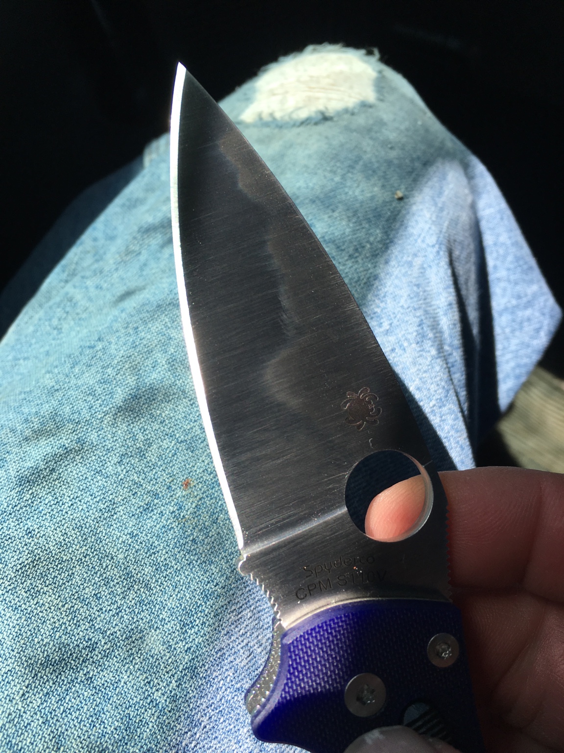

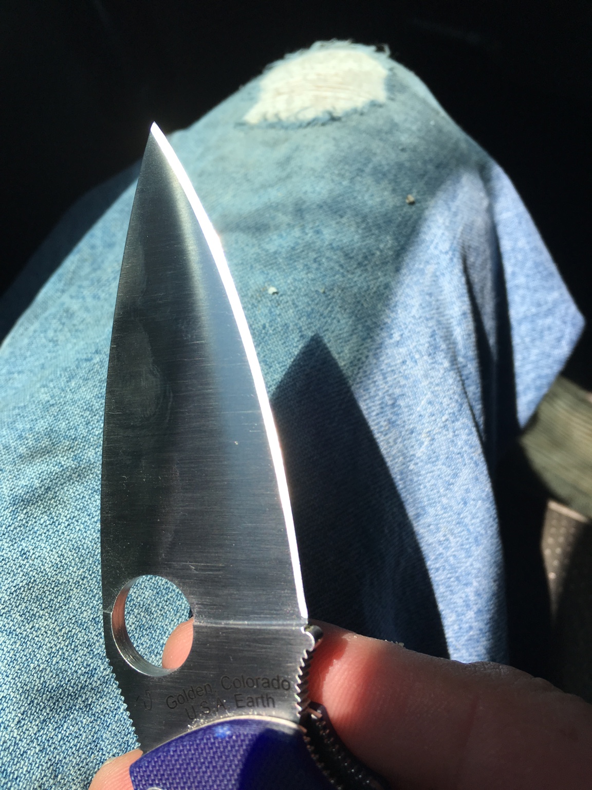

I recently got a blurple Manix and I've never seen a more perfect edge. Sharpest of any Spydie, or any prod model! Also, perfectly even bow to stern!!! See what I did there???
Sorry for the bad pics. But hope you can see what I mean.
I have not touched this edge at all!
