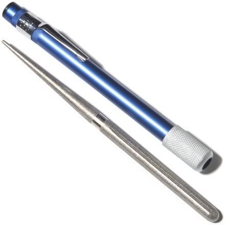

Whether you are or not, I use a Smith's Diamond Pocket Sharpening Rod.
One of these:
Use the thin tapered side. Start with the tip sitting on the serration, then lightly run it upwards to the serration. Just repeat this on all of them and then do one good clean sweep on the back to get rid of the burr. This has sharpened all of my serrated knives for about two to three years now.
Hope this helps, J.
