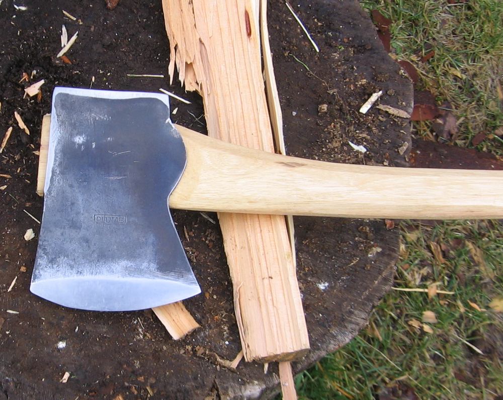

Hi all,
Looking for some advice on grind, profile, edge angle on an old wetterlings boys axe that I'm restoring to use as my new bush axe for camping and canoe trips.
A little more info on the axe and its intended use: 2 1/4 lb head, 24" handle. It will be a do-it-all, so will see duty chopping down standing dead trees around 6-10" diameter, limbing, cutting small diameter green trees for shelter-building, and splitting firewood. I'd also like to fiddle with carving and finer work, but that's very much a secondary use. Mix of hardwoods and softwoods like maple, oak, spruce, and pine.
I'd like an edge I can easily touch up and service in the field.
For sharpening, I have access to a range of diamond and waterstones, a puck, strops, and a worksharp with blade grinding attachment. I can get my knives hair-popping sharp, but I'll admit that I've never been that happy with my axe edges.
If you have suggestions for grind and angles, and if you've comes across any good sharpening vids or tutorials that have made a difference in how you sharpen your axes, please chime in!

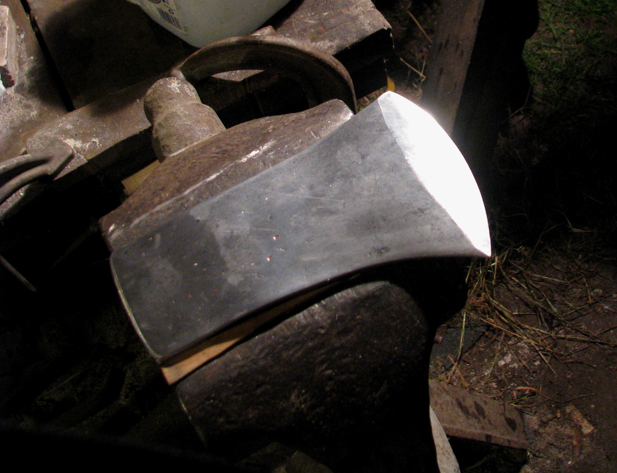

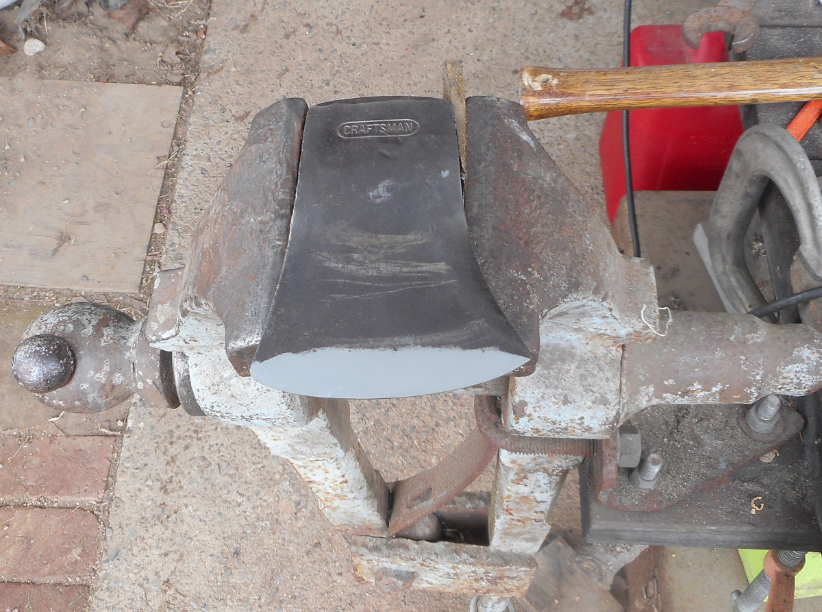

David, I understand the gloves. I personally like to stick the head in a vise to work on it before wedging it.
Sharpen to the gauge.
For a boys axe I'll end up at about 20° measured 1/2" back from the edge and then rolling to about 25° at the edge. You can go a little thinner if you're mostly using it for bushcraft not chopping or splitting (things you may or may not do at camp).
If your axe has a high centerline (aka convex cheeks) then following the gauge will give you a grind shaped like a banana or half banana depending on the thickness of the cheeks.
I like to leave the edge angle a little thicker at the heel and toe because these areas are the most easily damaged.
