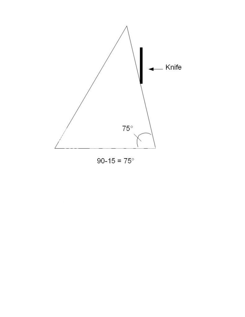

Thanks for the replies, and that makes some sense. If you have a knife with an established angle, how would you measure what that angle is? Better yet, how would I approximate the angle that I'm freehanding? Any thoughts?

You could do the same sort of thing by using a protractor to construct some angles on cardboard at 15° and 20° (or whatever other angles you wish). Cut the cardboard so that you have free-standing triangles. Mark the blade with a Sharpie, then make backwards swipes along the angle you made and examine.
I fudged together an illustration to make it a bit clearer. If the interior angle is 75° and the base is flat, then that side will be 15° off vertical. You can hold the knife vertical and rub it against the side of the cardboard.
Hope that helps,
Frank
