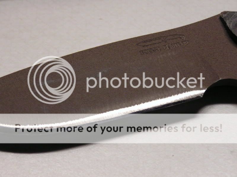

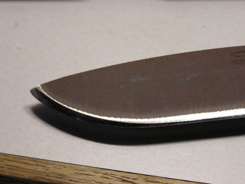

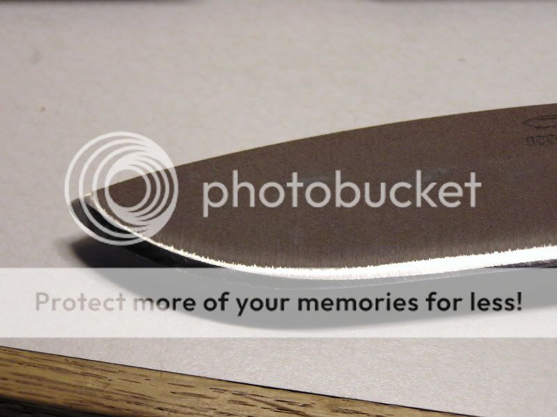

No safe queens! If I spend $$$ on a knife, I want it to perform, and these will. Here you go!
I fixed 'em for you. :D
