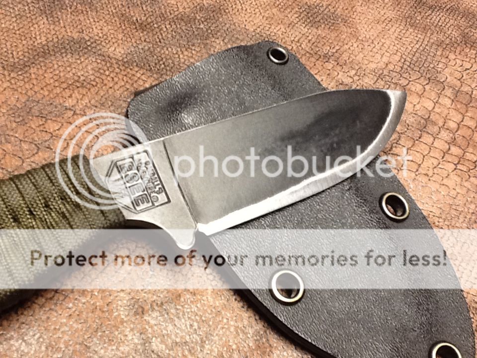

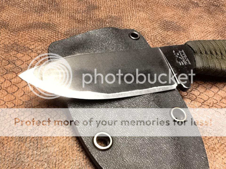

Virtuovice on youtube can show you how. Here's mine.
