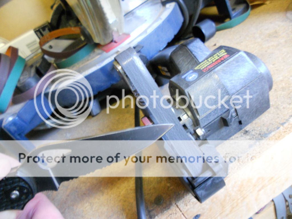

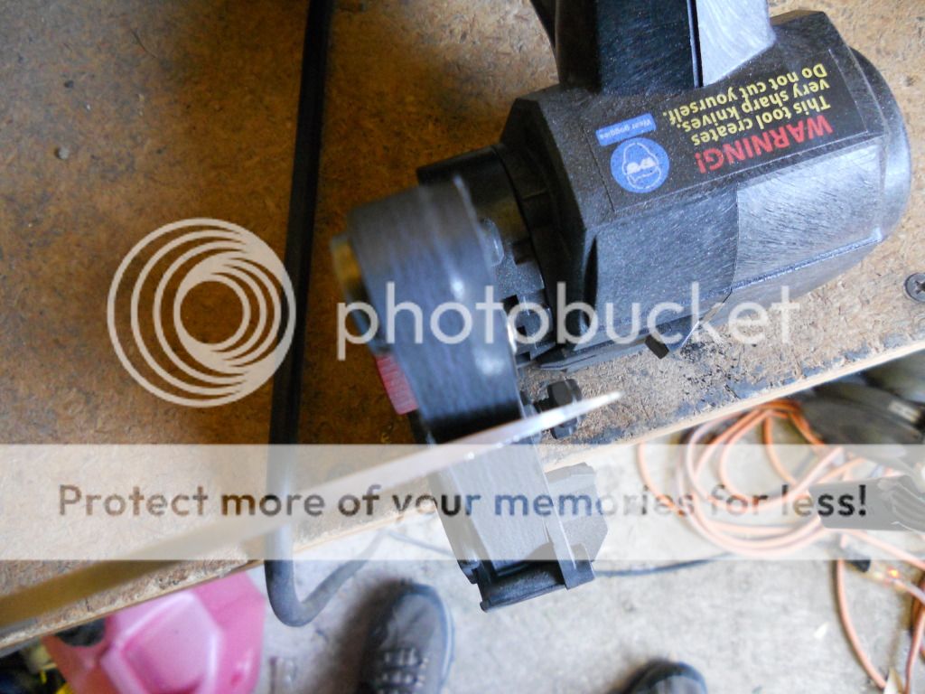

6. Blunting the tip is something to worry about with the WS, but once you've got the hang of it, you can easily Convex all the way to the tip with no problems. Just make sure that the tip never comes close to the edge of the belt. The tip should only go about a quarter to halfway on the belt, then lift it off the belt. Again, this is really, really tough to do with the guides, one-handed. Without the guides and using two-hands, it is easy. Here's a pic of how far you should go before lifting the blade off the belt.
Here are the tips of some of the blades I've convexed. No blunting here.

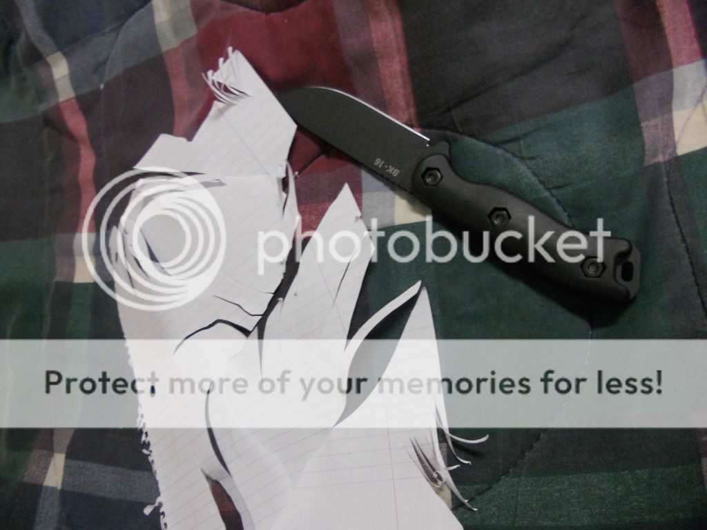

With enough practice, if you've done this whole thing right, you should be able to get an edge that will do this without stropping.
