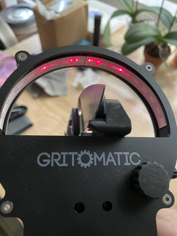

I have measured bevel angles on 15 Spyderco knives using a Gritomatic laser goniometer. None of the knives are Militaries. There are 2 PM2s, 4 Para 3s, a Sliverax, a Canis, a Yojimbo, a couple different Enduras, a Stretch 2XL LW, a Lil Native, a Pacific Salt 2, and a Subway Bowie.
The Subway Bowie has a primary bevel angle of 6 DPS (Degrees Per Side). All the others are 3 DPS.
The secondary bevel angle on the show side ranges from 15 to 28 degrees. On the other side, the secondary bevel angle ranges from 15 to 25 degrees.
None of them have a tertiary bevel or micro bevel that I can detect. The Endura Thin Red Line, Sliverax, and Stretch 2XL LW have convex edges.
