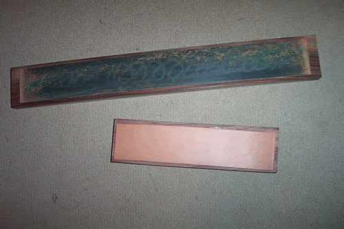

Guess I could convex it with enough time on the black compound or use sandpaper on my strop? What grit would you guys recommend? I've never done this before, but do like convex edges.

Start with 320 unless it needs a serious re-profile. 220 if it does.
Then go 600, 800, 1000, 2000. These will be found at auto supply stores in the body section.
I made a second "short strop" to put sandpaper on. The leather is harder than a mouse pad but offeres more control when using sandpaper. Long strop measures 23," short one just under 12."
Where did you get such a long piece of stropping leather?
