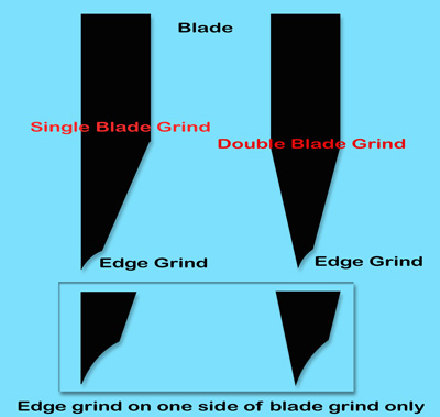

The edges of most of the CRKT knives I have come with a good working edge, but not a wicked sharp one. I've also noticed they have chisel grind blades, which many of their customers don't much care for.
Emerson Knives makes many if not all of their current blades chisel ground. The reason is found in its FAQ: "A chisel ground knife, being beveled, (ground) on one side only, possesses greater strength, (due to increased cross sectional mass) and they cut with an ease not found on any other type of blade. This is because there is no parasitic drag produced by the flat side when cutting—no drag points. On top of that, they are much easier to sharpen—you only have to sharpen one side."
If they only knew the benefits of such a grind, they say, most knife owners would want their blades chisel ground. But why did they put the grind on the left side? "Our tests and those of a major government agency determined that there was no difference between right and left side grinds for use as a tool or weapon. The left side was chosen for purposes of visual cue and reference."
Fine. Makes sense to me. The fact remains that even with CRKT's Slidesharp, I'm having a tough time getting my CRKT AUS8 chisel grind knives anywhere near as sharp as my Cold Steel AUS8 blades. Does anyone know why and how I can rectify it? I've noticed that the ground edge is highly polished and I'm wondering if that mirror polish has anything to do with not getting my Slidesharp, or my Spyderco Sharpmaker, rods to bite into the steel.
Please also let me know if you buy Emerson's argument that chisel grind edges are the best way to go for folders.
Looks like a tough edge to sharpen if this is an accurate
rendition of a chisel grind.
every knife i make is a chisel grind. i have no problem getting them sharp. i have also made a left handed knife for a friend that was ground on the right side. i sharpen both types the same way. which style knife are you trying to sharpen? i might be able to help you more if i knew the blade shape. if you want a good edge on your knife i would be glad to put one on for you. that way you wouldnt have much trouble putting an edge back on the next time.

I think chisel-ground, Japanese kitchen knives like the usuba and deba are actually slightly hollow ground on the unbeveled side to prevent food from sticking. They're also beveled on the outside (right side for right-handers) for precision placement. "The left side was chosen for purposes of visual cue and reference," sounds like, "It looks better in photographs." Not a bad reason for it, but not the best I've heard.
And I'd like to know more about "cross sectional mass." I'm not sure I understand either the concept or how it relates to strength.
