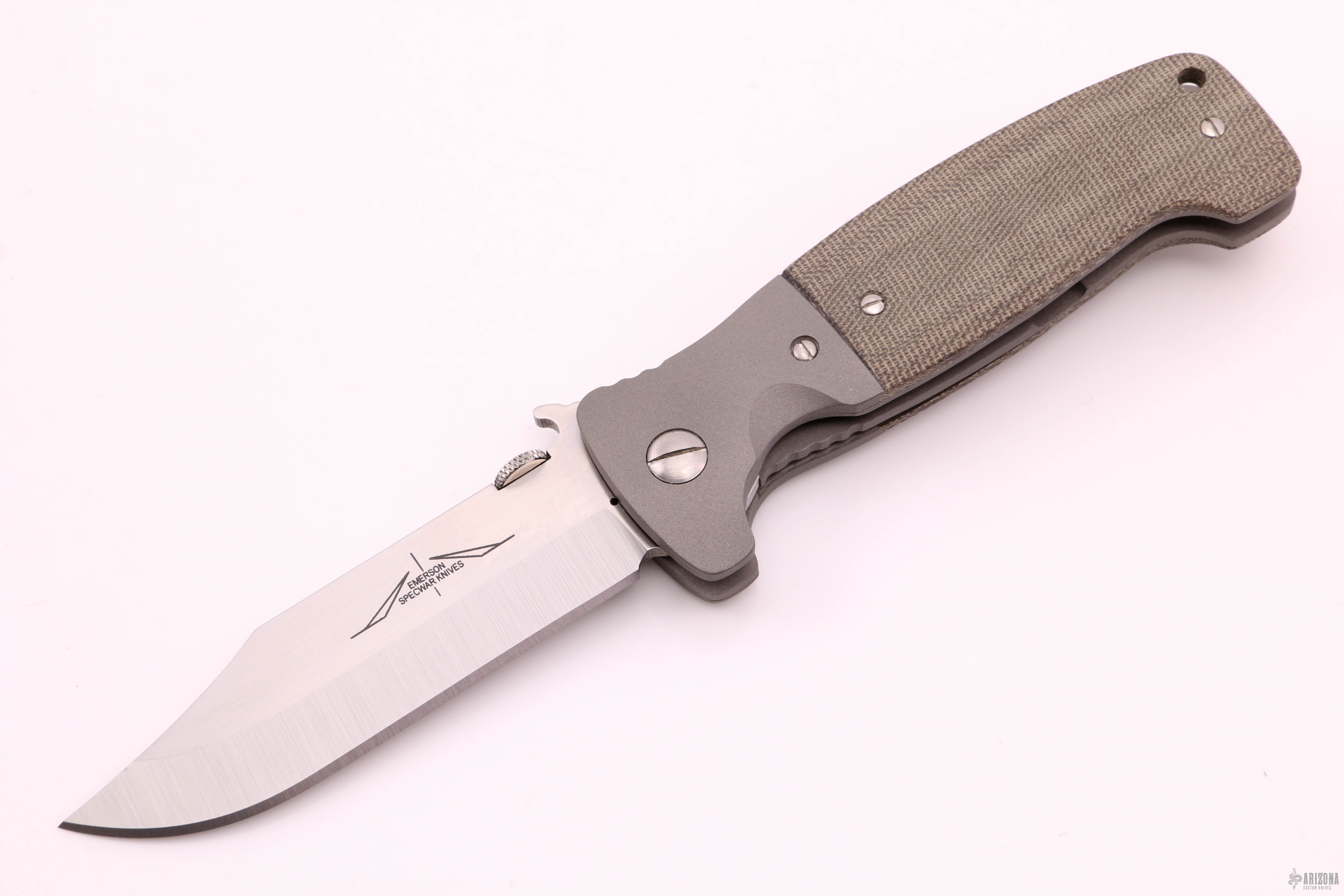

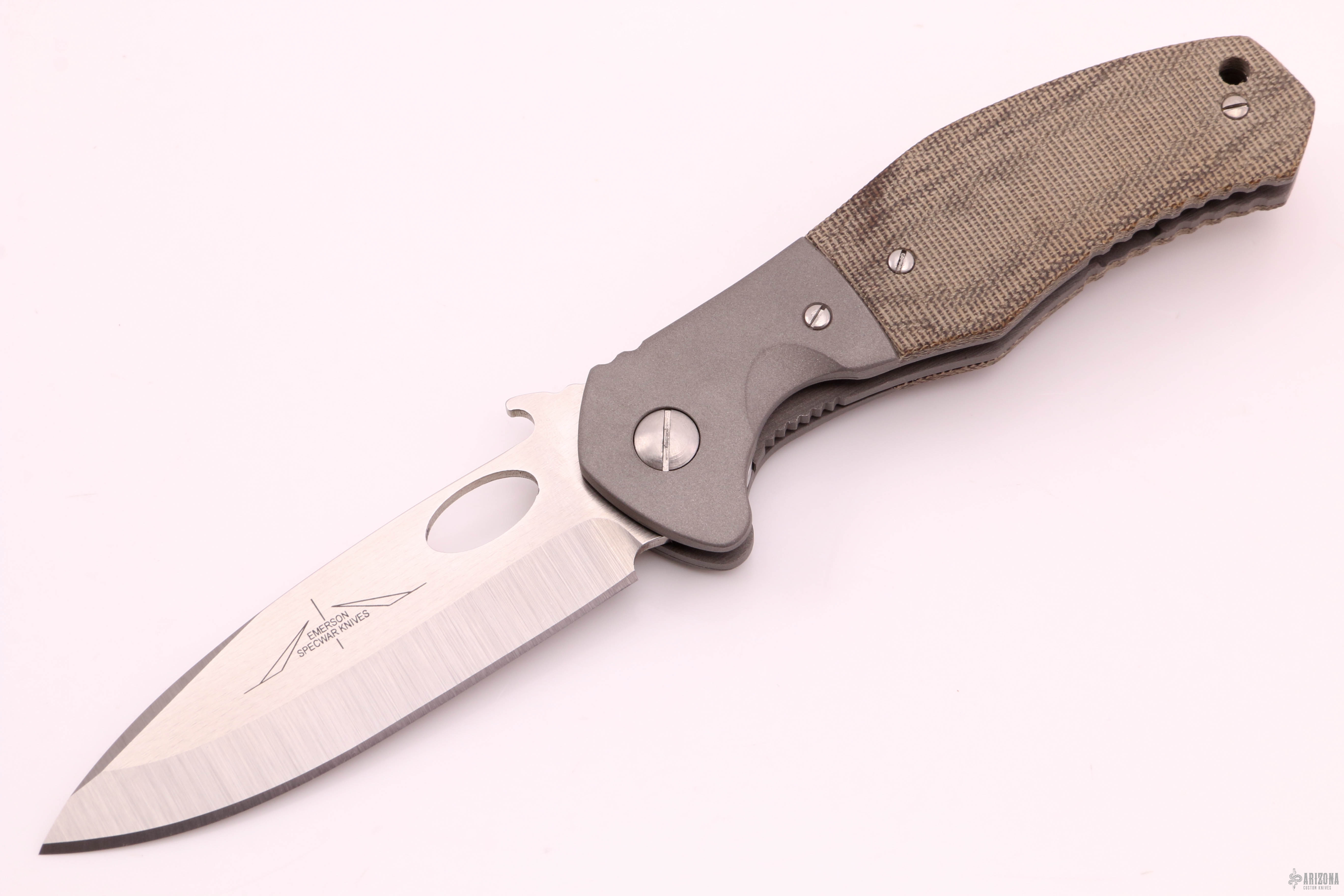

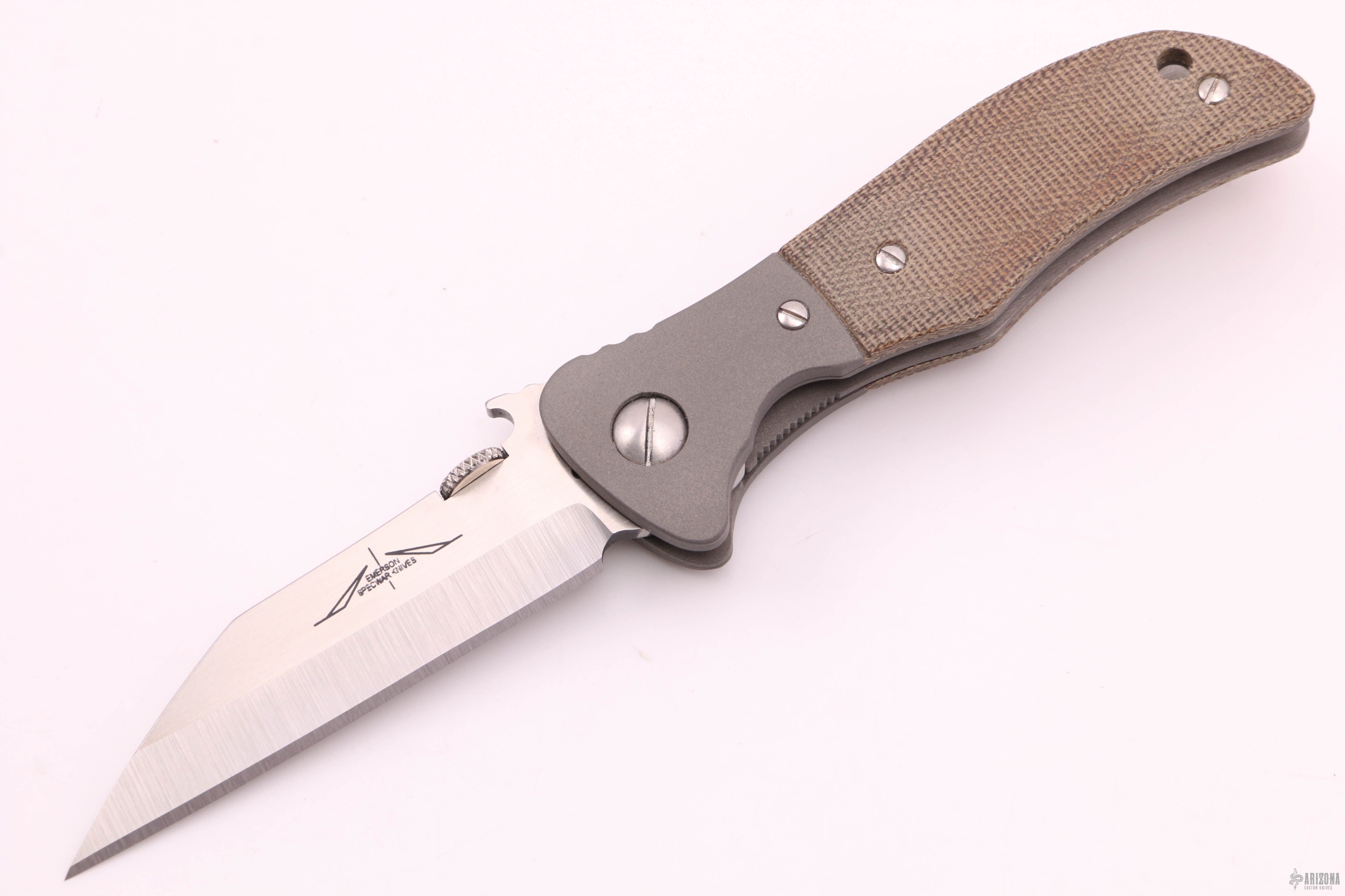

Not all custom Emerson's come with a zero ground edge. Those are usually done on customs where he chisel grounds the blades (one side flat). Most of the custom tantos will have a zero ground chisel edge like the CQC-7, Bulldog, Roadhouse, and some CQC-15. However, the CQC-10, CQC-12, and Seax are V-ground with a chisel edge like their production counterparts.
As for sharpening... Adding a micro bevel or using a strop is ok for touch ups as long as you don't mind how it looks on a zero ground edge. But if it is really dull, I use sand paper of various grits mounted on a very flat surface like my DMT Diamond plates. Then I lay the blade bevel flat on it to regrind it until sharp. Change sand paper to polish the bevel to the level you want after initial grind.
Try not to sharpen the flat side of course. Doing the recurve on the cqc-15 could be tricky and you may need to mount the sand paper on a slightly curved surface to do it.
Some pictures of my sharpened Bulldog and Government Mule-B
y4mkoEQlJUBrniuZU7ZSXRKzn8oyRagZ-ZGZMHeZB4G8r8os3kBSGMGyS5tc3wOEmJbwiOwUvpD_6OTbtLKRTfIlVbngW9G9abIqni6WsVOV-c850et9ermrd-cNU28vW8pajZWmcTDqOUQt8Zx140CuCk8aUS4EPBbKk8GnjJThm5cYOYrMiqLjmyY3tNDTJYb
y4m0BIQA3R3R7aEIgXoUz6TI0XQzQDd43T6A6kJOQEiwlTowWTzZ8fivIZ2seWo7vNvUYdTNt8Zz1CWiBVySl8QTSM3sqHLI9kSydJAk9MHk4SpZL0mhLBqUK8BrdzAivOSdzgRTAYCEgceAmXkgxna_WGUZthQBolFDb3UfDNR-ov8MYNQgVLjreTL0c6ANzNN
Thanks for the reply!
Those look very nice, amazing job. Could you tell me which grits do you use?
According to my notes, I used 120 grit, then 220 on those customs pictured. Occasionally deburring on a Spyderco ultra fine bench stone during sanding. Then finishing off on an unloaded leather strop.
On another knife, I used just 150 grit start to finish and it looks pretty good too. Same deburring and finishing process.
You can of course use higher grit sandpaper for a more polished look, but I was trying to keep a similar look to the original grinding.
