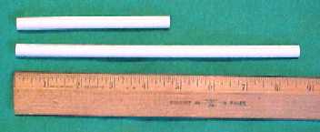

Okay, another question
What about the lenght of blade from cho to belly, how the hell do you get the right angle on that with a sharpening stone. If you use the edge of your stone you make it round (eventually)
Brendan
"Okay, another question"
Brendan, you might want to try one of these on those troublesome reverse curves;
It's a ceramic sharpening rod available from www.ragweedforge.com
You can't beat the price, the 4 1/2" rod sells for one dollar, the 8 1/2" rod sells for two bucks. Yvsa mentioned a while back the effectiveness of gluing leather around a wooden dowel (1" diameter, if I remember right), loading it with compound, and using it to strop the curved edge of a khuk. I've tried it with great success, thanks for the tip Yvsa.
Greg
