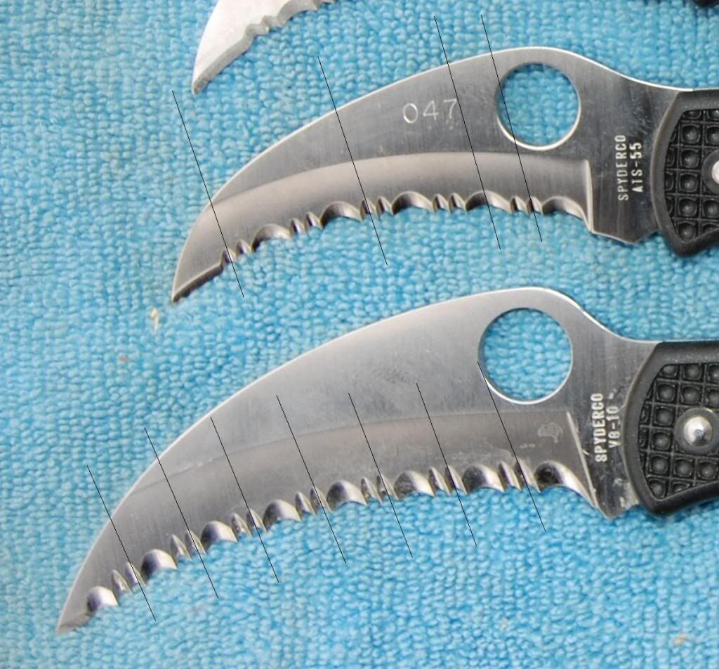

The big question is, plain or serrated? Plain edge is easily sharpened on the SharpMaker or 701. The Byrd Duckfoot diamond sharpener is inexpensive and works very well for faster stock removal. The only caveat, as mentioned, is the wrist motion needed is backward from what most people are used to. I have to fight muscle memory every inch of the way., which makes keeping the blade vertical a problem. try propping a mirror up behind the SharpMaker where you can see the tip of the blade in the reflection.It makes it easier to see if you are keeping the blade straight.
For serrations, it gets a bit trickier. Serrations are ground all at once on a shaped wheel. They do not follow the curve of the blade. You need to find the correct angle for the handle to match the serrations to the rods, then hold that angle throughout each stroke. If you try to follow the curve of the blade, you will round offff the points of the serrations.
Here is a picture I made a while back to show what I'm talking about.
Notice the lines down the centers of the scallops are parallel to each other rather than perpendicular to the edge.
