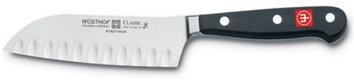

Thanks, David. I'm looking at a 5" Wusthoff Santoku. My problem is that the Chef's Choice grinds at 20 deg. I didn't buy the 15/20 model b/c I don't like compromises and at the time had no knives needing 15deg
If this^ is the one, I don't think you'd have any issues sharpening it on the Chef's Choice. My own preference for edge angle would be at 15°/side (or lower ;)), but it should be fine at 20°. Anything in that range is decent for knives like these.
