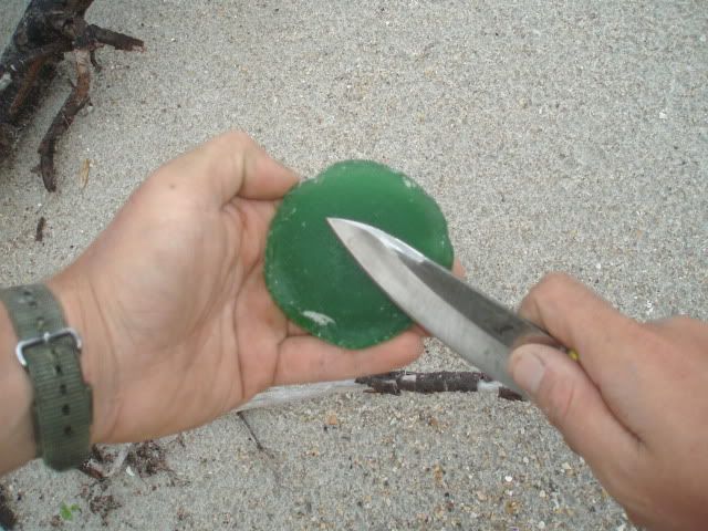

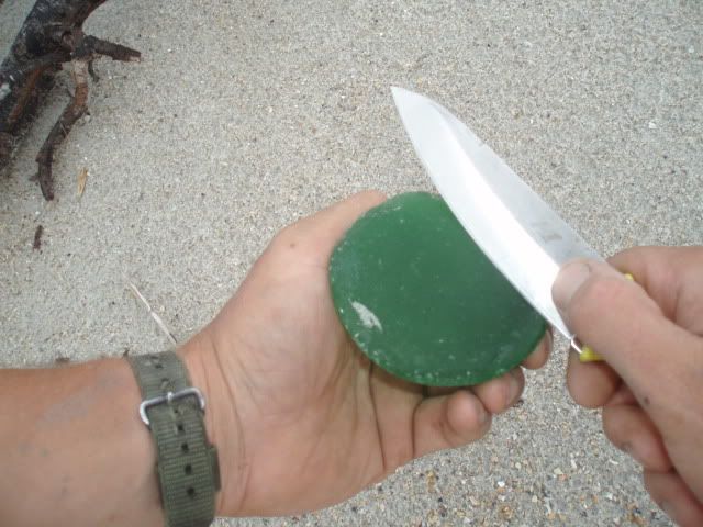

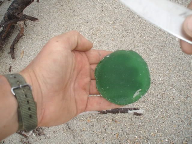

One time while on a beach "survival" (not really survival since I meant to do it...recreational survival?), i found the bottom of a well worn bottom of a tossed away wine glass

And Joe, that chunk of sea glass could sell quite easily to someone who makes jewelry out of it.
