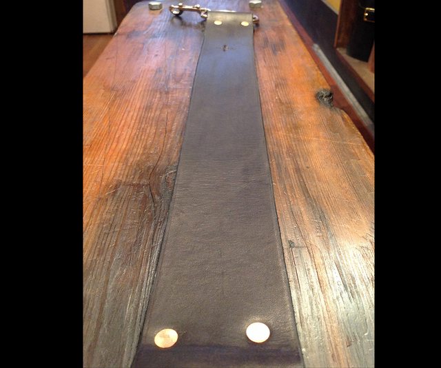

I like using these treated strops
too much pressure can over do it and remove too much material. Just keep a light touch and take your time.
