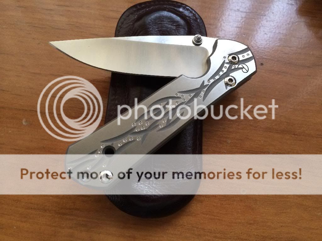

I just bought a used small classic sebenza and was curious, would using a Lansky fine diamond rod be ok for touching up the edge on my small sebbie? I've heard that diamond stones remove a lot of metal and I certainly don't want to do that. OTOH I've heard they are good for touch ups. Any advice would be appreciated as I am basically clueless lol.

It seems like the previous owner used the wrong sized hex bit on all the screws because they are in pretty rough shape. Otherwise it's in pretty darn good condition for being close to 10 years old. And I got it for an unbelievable price so I can't complain too much lol.
