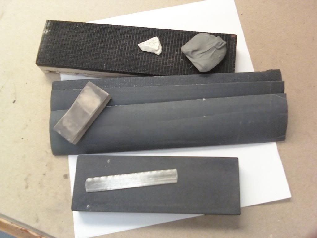

Here's my usual, the workplace version. WB with 180, 320, 600, one drip of white compound, a small slug of grey, copy paper, eraser, Norton Econo stone with hacksaw blade for whipping up a slurry if needed. Mineral oil off camera. The whole set-up survives very easily in my workbench environment, and ready to go at a moments notice.
My home set-up is very similar but the eraser is pink and the stone is a Norton Crystalon. I have a shelf full of stones, this is the kit that's been getting the call up for over a year now.

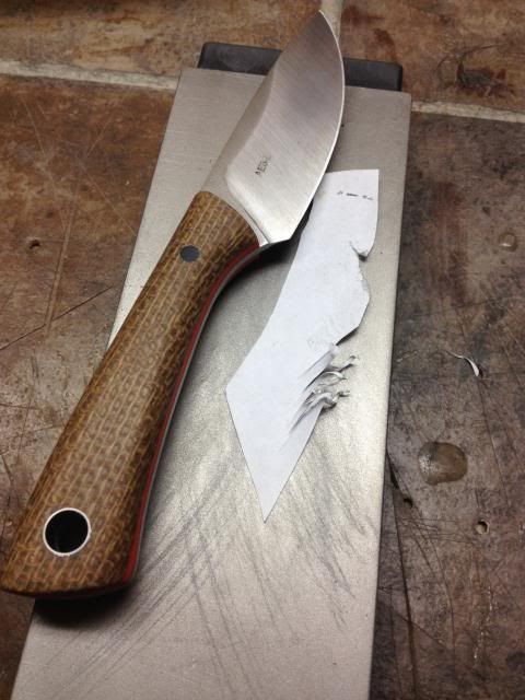

Knife was ground thin enough to set the bevel right of a x coarse stone, this is at coarse..Already very sharp.

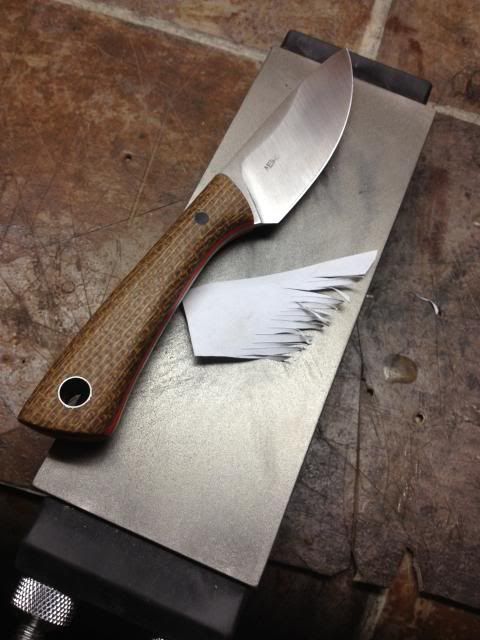

This is at fine, not much to see

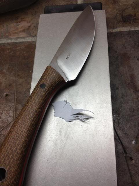

this is at x-fine..It can shave curlys as fine as you want and tree top hair.
