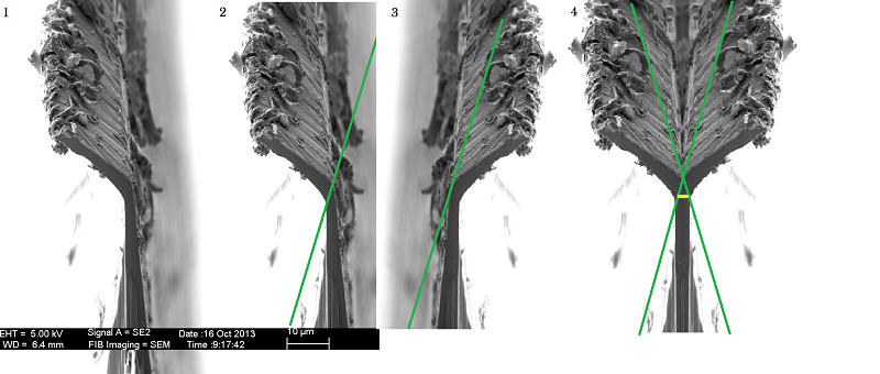

rollintent - try to visualise what is happening to the edge apex.
The very edge adjacent to the burr you've raised on the #1200 DMT has the apex width in the vicinity of 0.1-0.2 micron.
When you rub it against the 6 micron grains on the Spyderco Fine Ceramic bench stone, to raise another burr as you say, you shift lots of metal from the apex to the side of the blade.
Below is an oversimplified modelling of what is happening during sharpening.
SEM image by courtesy of Todd Simpson scienceofsharp.wordpress.com
1 - the burr is raised by grinding one side, at this stage you even out the bevel
2 - you start grinding the other side and evening out the bevel
3 - the burr is raised on the other side
4 - you minimise the burr by grinding with minimal pressure
Then deburr

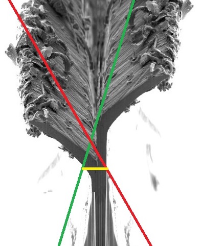

The next picture shows what happens when you repeatedly raise the burr overgrinding the apex:
The resultant edge apex width is shown by the yellow horizontal line.
Generally, the abrasive grit #1000 is where you raise a fine burr, upon removing which you get a true razor sharp edge.
