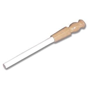

Is that ceramic?
No, it is a borosilicate glass sharpening rod. Supposedly it is the ultimate steeling rod, but they are expensive and the company that makes them has been having financial problems. They have been "out of stock" for a very long time and nobody that owns them ever sells them on the used market. As I understand it, they are popular with high-class professional chefs who depend on the sharpness of their blades to give them exotic cutting abilities that make them worth their salaries. For the pros, $100+ for a steeling rod is nothing.
A couple options for $10 or less:
Big John Super Stick (1" diam ceramic, 16" OAL)
Craftsman Diamond Butcher Steel
