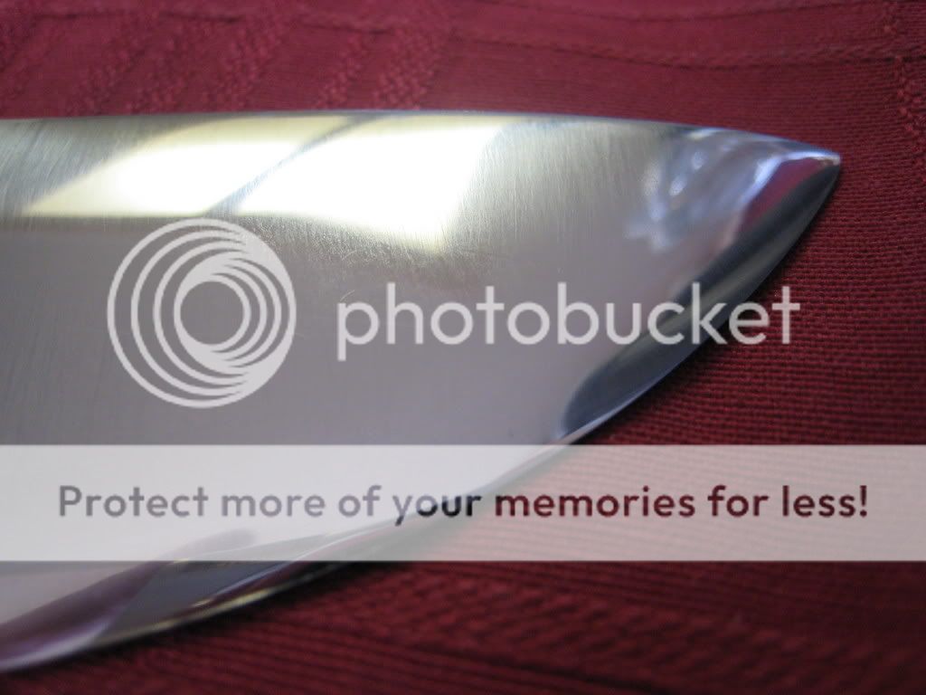

OhNO!! Begin with 100 grit!!!
I do 100
180
220
400
1000
1200
1500
2000
polishes
but i am a nutcase!!! I use LEATHER because there's no way I can press too hard and screw it up!!

Dang, Tom! That's a pretty nice edge you've got there. What would it take to convince you to put a nice edge on a certain Mudsnake FBM before you drop it in the mail?
