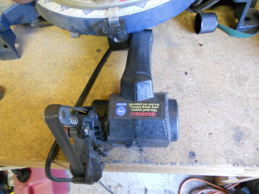

I'll second the Work Sharp, but I jam the handle under a chop saw and use mine without the guides to grind on it like a normal belt sander. The nice thing about a Work Sharp is that you won't remove much metal as you would with a normal belt grinder and it's much, much harder to overheat the blade.
I set mine up like so. Works great.
This allows you to follow the existing bevel instead of creating a new secondary bevel. Get some of the high grit belts as well so you won't remove too much metal at once. You won't need the 80 or 220 unless you damage the edge. I don't think you'll want to give a kukri a secondary bevel, especially an HI model. Just sharpen along the existing bevel angle and you should be fine. My WWII model already has a perfectly good bevel as it came. No need to blunt it with a secondary bevel. Unless you're talking about a Becker BK-21 or a Cold Steel kukri that already come with secondaries, and then a 40 degree inclusive convex edge might be a good idea. My Becker machax, a kukri-like object, has a 40 degree edge on it that works great. I also had a 40 degree on the Ontario Spec Plus kukri I used to own.
