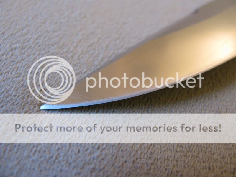

My setup is HUD approved, knife sharpening nut not, so I said F the sandpaper and went to my DMTs once I realized the diamond compound extends all the way to the edge. I had to keep the fine and extra fine clean, but it worked. You can see the scratches I had with the sandpaper...
