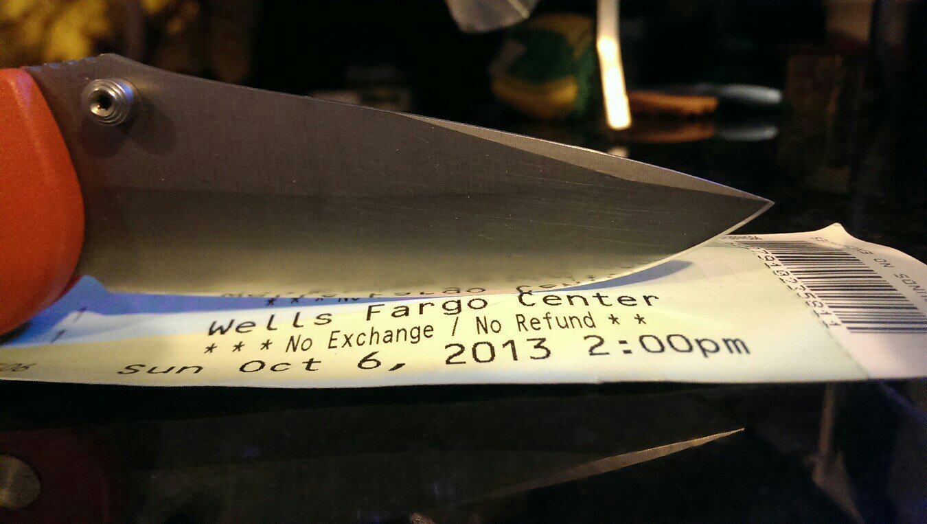

I would like to try waterstones are even the cheap ones better then the ultra fine here's some X15-TN steel
