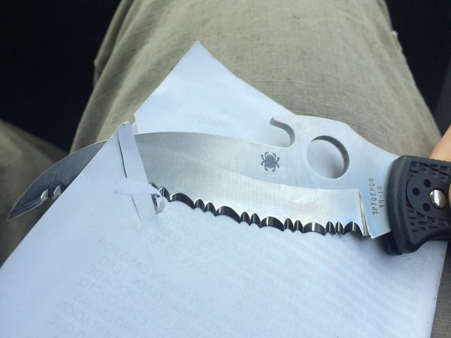

I've been sharpening serrations on the Sharpmaker for about 13 years and it doesn't deform the serrations in a bad way at all. All the points are just as pointy, and the concave sections just get more polished. I sharpen both sides and use light pressure against the rods. I try to alternate pushing and pulling strokes to make sure I hit all the curves evenly. I go all the way up through the ultra fine rods. Works great, and there's nothing like a Spyderedge that's crazy sharp.

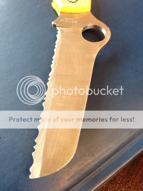

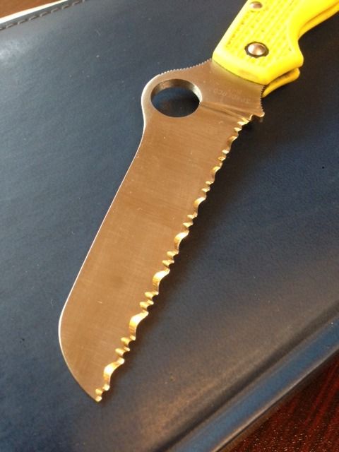

I have used my Atlantic Salt for site work for 4 years now, sharpened it numerous times on just a stone on the back of the serrations, reground it as well. For site work I prefer SE as I can cut everything required. Not pretty cuts but separate two materials from one another.
When the day comes that the inner scallops are almost parallel to the teeth all I am going to do is take a rat tail diamond file, dremel and rework them. Boom, another 4 years + of service. One of the best knives I have ever bought.
[/quote]
Here are some photos of my brothers knife. It's been sharpened a handful of times in the last year with about 3-4 trips to the stone, most of the time it's just the polishing wheel though. You can see the faint line at the top of the blade grind where the stone touches on the backside.
