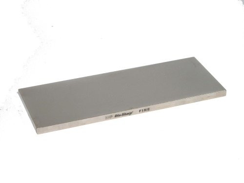

Can anyone recommend me a sharpening stone for 10" + blades, my current stones are too small to make a complete pass, thanks in advance.
On a blade over 10" I hold the stone in my hand and move it along the edge. I've had a time finding a a stone big enough as well. With a steady hand it becomes rather easy to do.

Gayle Bradley (BladeSports International) and DMT teamed up a couple of years ago to design large bench stones for the big 10" blade competition cutters in hard-to-sharpen steels like CPM M4. I have the DMT 10" Dia-Sharp® Bench Stone which works well for me in 1200 grit. Surface is 10" x 4" with 5 carats of continuous-surface "micronized" monocrystalline diamonds. The stone comes in coarse (325 grit), fine (600) or extra fine (1200) for around $100, which is not cheap but for those who don't want to go the belt grinder route it's compact, easy-to-store, and should never have to be replaced.
Norton stones are available through butcher supply stores in an 11 1/2 X 2 1/2 X 1/2" format. The coarse and the medium stones are Silicon Carbide (Carborundum). The fine stone is Auminum Oxide (Corundum). They are available loose or on a rotating prism in an oil bath.
