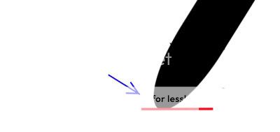

Please excuse my Photoshop work but the above diagram is of a blunt convex edge profile. At first I was a bit put out by the "curve" rather than "flat" edge, but I now know that it is only a matter of removing a little metal around the bottom, to sharpen the knife.

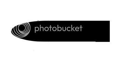

Above is what I am aiming for. By removing a little from each side I will have a sharp edge, and will retain the strength of the convex shape. That is, plenty of supporting metal behind the edge. (Please note that this diagram is exaggerated for clarity. The amount of required metal to be removed is much smaller than this indicates.)
The main thing is to concentrate and get a "feel" for when you are on track. Your eyes will tell you if you are going wrong so check often until to no longer need to. This takes practice.

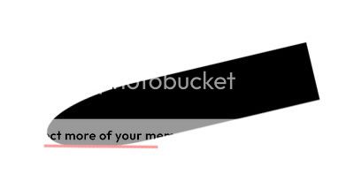

In the above diagram the knife has been held at too flat an angle. This will remove metal from the shoulder above the edge, while leaving the edge untouched. You will see this easily and can adjust. Again, check often until you get the "feel" dialled in.

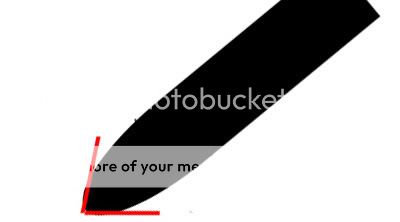

In the diagram above, the angle is too open. The edge is being removed but is being flattened rather than sharpened. As the arrow indicates, this is easily seen by checking the OTHER side to the one you are working on. This check will quickly show whether you need to adjust your angle or not.
