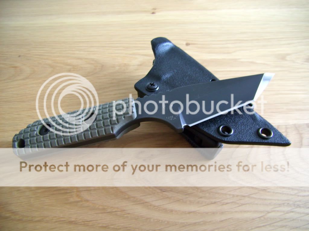

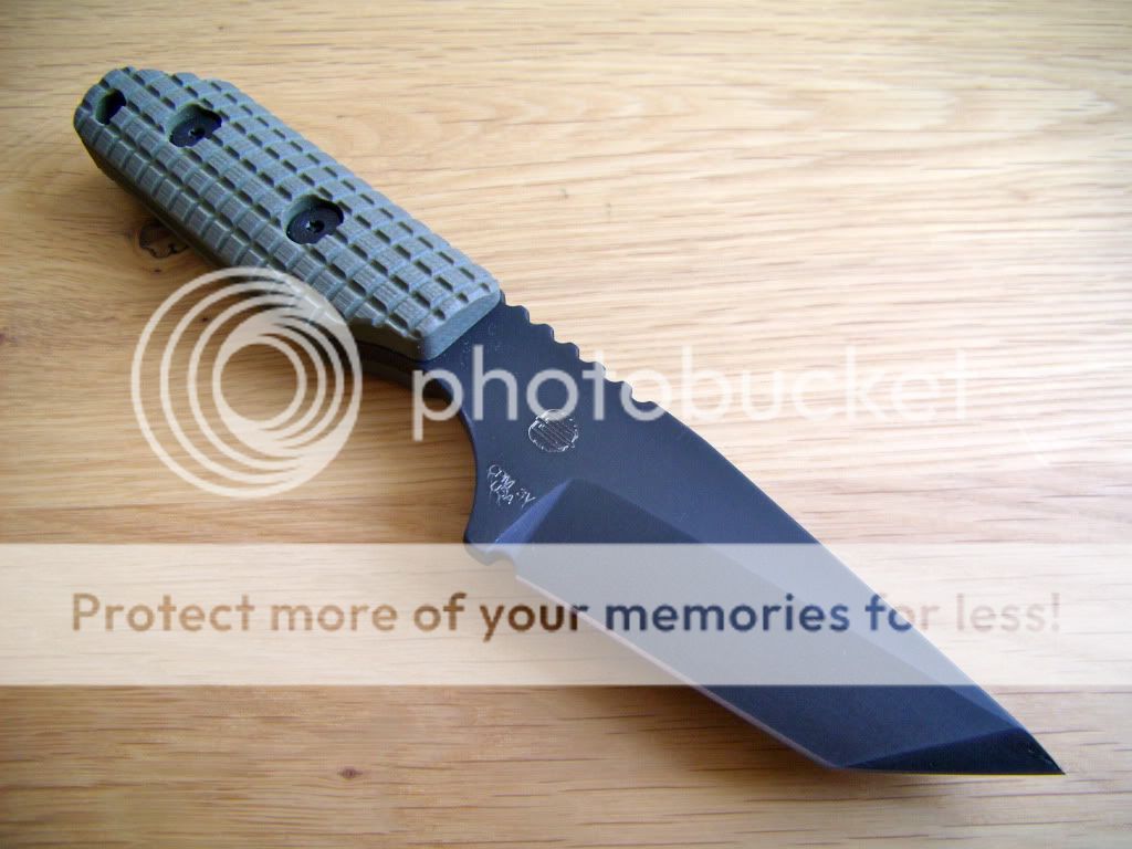

If the edges get a bit wider, especially the slanted edge, then i tend to use my Tormek, like on this Strider GB.
The factory edge had a wide angle and was also quite irregular, so there was room for some improvement.
As you can see i didn't refine the scratch pattern on purpose (as i think it looks good on a knife like this), only removed the burr on the Tormek leather honing wheel, followed by some stropping on a leather handstrop coated with 6 micron diamond paste to create a slightly convex microbevel.
The straight part of the edge now measures around 25 degrees inclusive while the slanted part is about 30 degrees inclusive.

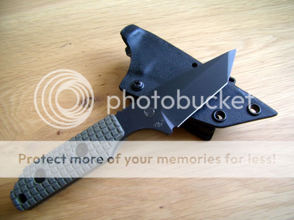

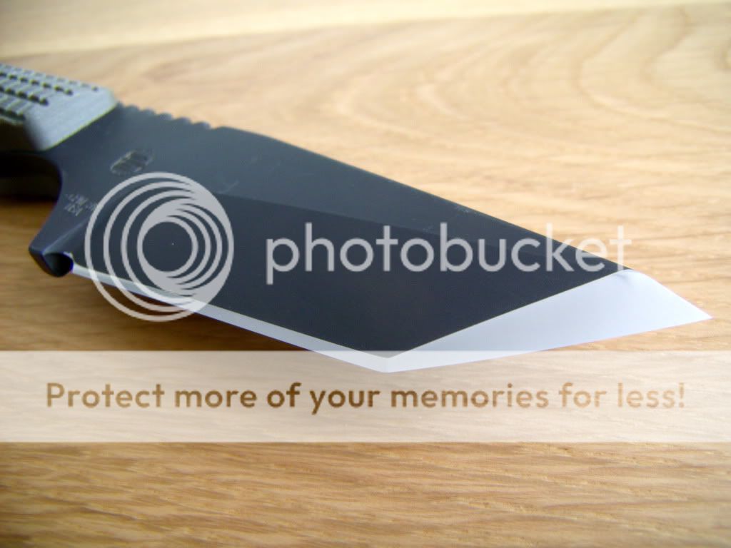

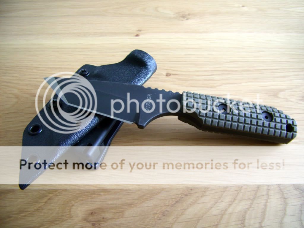

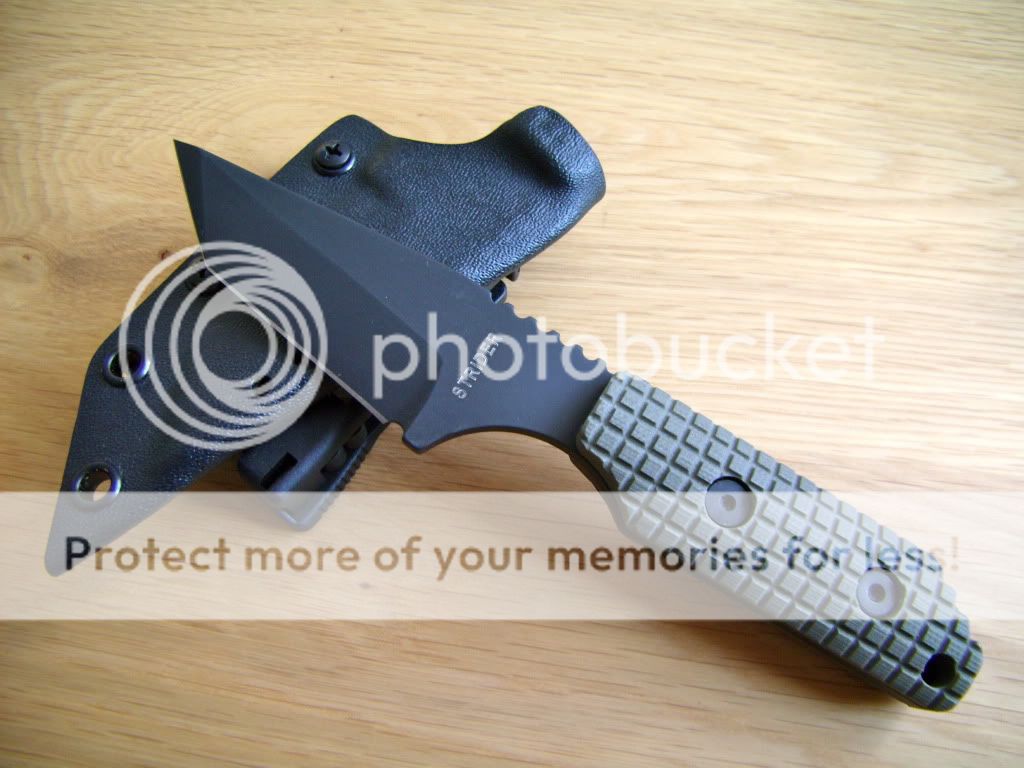

Or i use a combination of Tormek & Wicked Edge, like on this Strider DB-L some time ago.
This is a limited edition of the DB model in CPM-3V steel and made from thinner stock than the usual S30V versions.
Originally it looked like this:
The straight edge was reprofiled on the Wicked Edge sharpener to 30 degrees inclusive & polished up to 6 micron 3M diamond paste, while the slanted edge was done on the Tormek T7 to 45 degrees inclusive & polished up to 15 micron 3M diamond paste.
Both edges will treetop armhair, while the straight edge will also whittle hair in some places.
Now this DB can and will cut, and it still can be used as a sharpened prybar in an emergency.

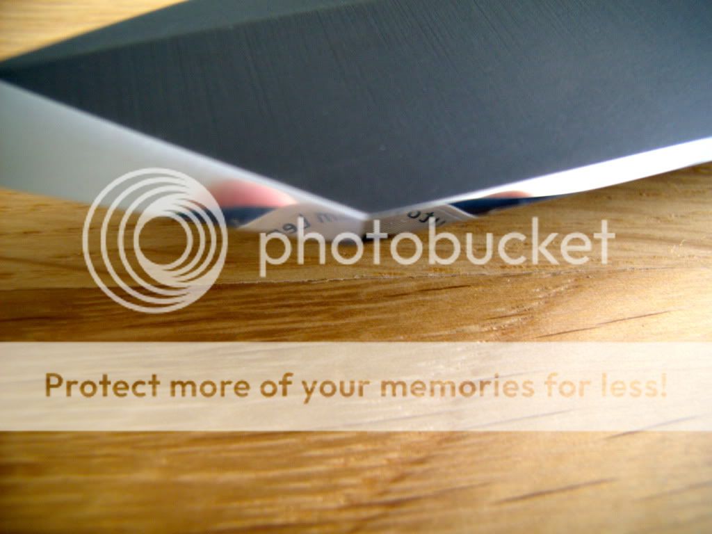

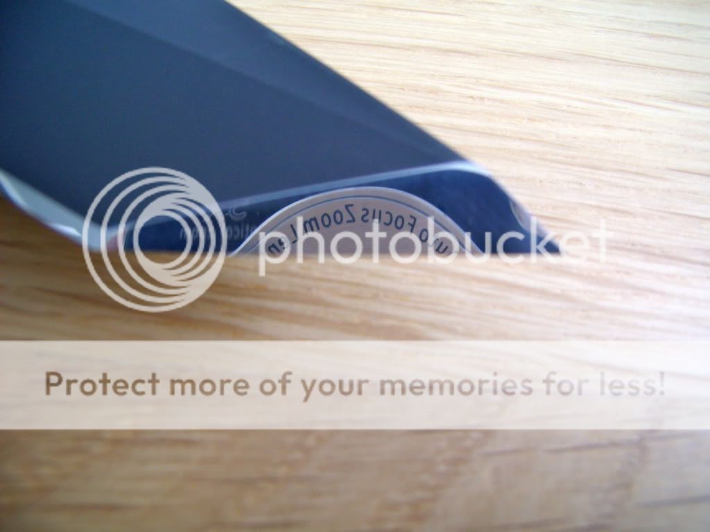

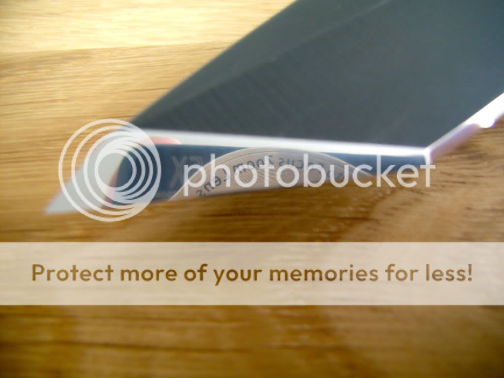

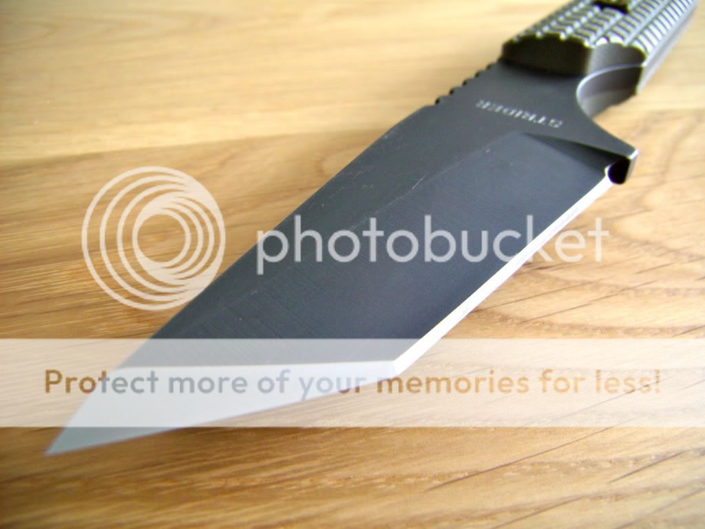

Some close-ups:
Difference between 15 micron and 6 micron;
