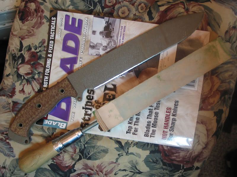

Hillbilly.223, do you have a picture of your Busse air bleeder strop? It sounds like an interesting piece of equipment, but I scoured the net and could not find it.
Here is a pic of mine:
The Busse Air Bleeder Strop sold out a while ago. Here's a pic that I had handy. The wooden handle was omitted when I shot the pic.

Thanks to everyone who posted pictures of the Busse air bleeder.
