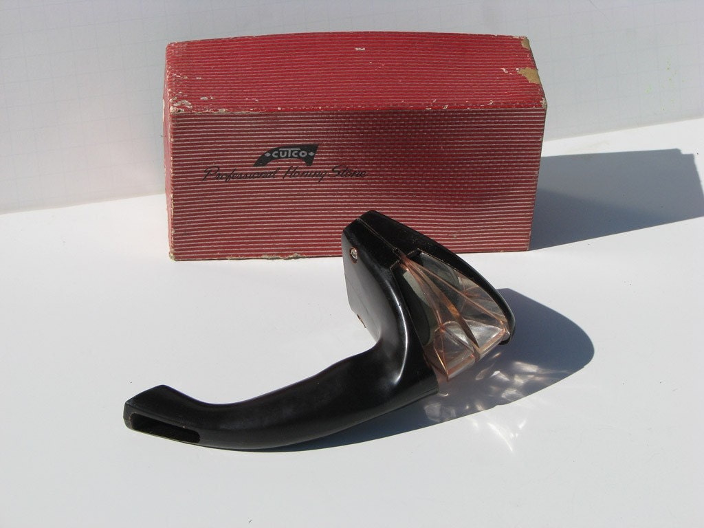

I use an old Cutco sharpener I got at a yard sale. You line up the back of the blade with a raised edge (to set the angle) and you just pull through. I know there are probably better ways to sharpen my Kabar, but this works fine.
I've never had any luck with stones. I have two stones, made by Smith that I got at ACE hardware, and I tried to sharpen things like a normal person, but it just wasn't happening.
It looks like this:
