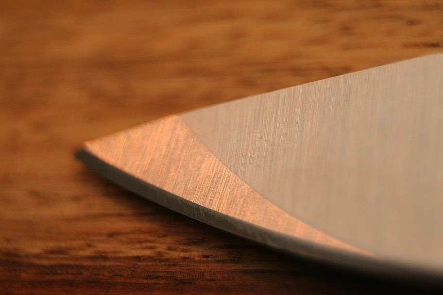

I absolutely love this knife! The slender, but thick, heavy duty build is right down my alley! The only problem I have is getting this knife as sharp as my other two Spyderco's; Perrin PPT, and Titanium Military.
I realize that the PPT and Military are both flatground blades, while the Valotton is a hollow ground blade, with the convex grind for the last 1/2" of blade out to the tip. It's not that the blade isn't sharp, because it is, and will slice newsprint with ease. But when trying to shave hair it will not do so evenly, or across the whole length of the blade, with the tip being the "dullest portion".
I use what I've used for the past 25 years, and that is a Sharpmaker sharpener. With new knives that have a good edge, like the Spyderco's, I only use the white stones to touch them up with as that is all they really need.
Guess I'm asking, is there a better way to sharpen this particular blade? Should I use the gray and/or diamond stones, or just continue to sharpen with the white stones until it gets to the point that I want it to be?
The Valloton seems to have a thicker edge. I think I saw somebody also post about the thickness of the factory edge. A rebevel will make that high hollow grind slice like a demon.

You can't use the sharpmaker on a convex tip. You have to use a flexible surface, such as sandpaper on top of leather. If you sharpen a convex edge on a sharpmaker, using the angle guides, you will ruin the convex nature of the edge. Spyderco should have included instructions on how to sharpen the blade.
Also, a convex tip will not "hair-pop" at the same angle as a the rest of the hollow grind blade, so the tip may be sharp enough, but will cut better at a slightly different angle.

I was not aware the Vallotton was not a "true" convex edge, I have not seen the blade, just the description on the spyderco website. Is that a convex grind with a saber edge :)
Few pics:
EXCELLENT pics Philwar! I've simply continued to sharpen using the white stones and now the edge is sharp from tip to choil.

As long as you are hitting the very edge with the Sharpmaker it will get sharp no matter what grind it has. Yes it will start getting a microbevel and lose the perfect convex shape, assuming it has one, but it will get sharp. Use the Sharpie trick to see where you are hitting along the edge.
Thanks for the advice FlaMtnBkr, and in fact I had already done this and found that I was hitting the edge where I needed to, and that it is now hair poppin' sharp!
