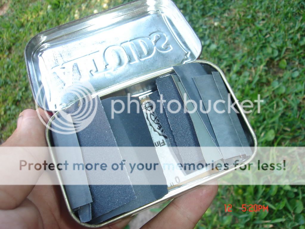

I'm in the process of getting a gransfors bruks small forest axe. I am aware that i'll for sure need the sharpening stone for minor touch-ups....but i wanted a file for taking a bit more metal off. Gransfors has two options here: a normal file...and a diamond file. Does anyone know which one I should get? Keep in mind, i only want to carry a few sharpening tools for the axe (not an arsenal).
I finally made a miniature convex kit 2 months ago and it seems to work great... strop normally and 180 - 800 (down to 120 actually) grit sandpaper depending what is needed. Been workin with it on some axes and hawks for two weeks and lovin it :thumbup:
when touching up or takeing a chip out of my sfa i useually use a convex edge sharpening kit if it is realy dull or has a chip i use 220 grit and mone up from there to 320 ,400,600,1000,1500,2000 then a short strop on brkt black compound here is a pic of the kit i made and use
how the sandpaper looks while on the mouse pad which is glued to the top of the tin

I've used Gransfors axes a lot and never damaged one enough to need a file. I use them a lot but I'm pretty careful with them and I don't lend them to anyone. A strop or stropping kit would probably handle the vast majority of your sharpening needs.
The Gransfors rep told me their axes are hardened to around Rockwell 57 so a regular file ought to be hard enough, if you someday need to file it. I'd buy the diamond file only if the price difference was small.
Where a file has come in handy for me is with beater and loaner axes. When someone dings up my 1970s era Sears beater/loaner axe, out comes the file. An axe file is also useful if you get something like a CS Vietnam Hawk and want to reprofile the edge (or add leading and trailing edges).

I use a strop and anywhere from 200 to 1500 grit strips of wet dry sandpaper on it to sharpen my GB's. Never had to use a file even when I chipped one.:thumbup:
If you are going to get a file, you dont need to spend the money on the GB brand file, you would be fine with a single cut file from the harware store, it would be alot cheaper. I dont typically use a file on them though, unless it is really bad. I dont like the mousepad set-up for sharpening either. With one of those I obtused my GB's edge accidentally, and had to send it to siguy to get it back to normal. I use an axe stone and a leather strop and that works well for me.

The diamond file is not going to remove much metal, it is called a file, because it is shaped like one, not because it removes metal like one. Also, remember with diamonds to lubricate with water, and to keep your pressure low, or you can uproot the diamonds.
