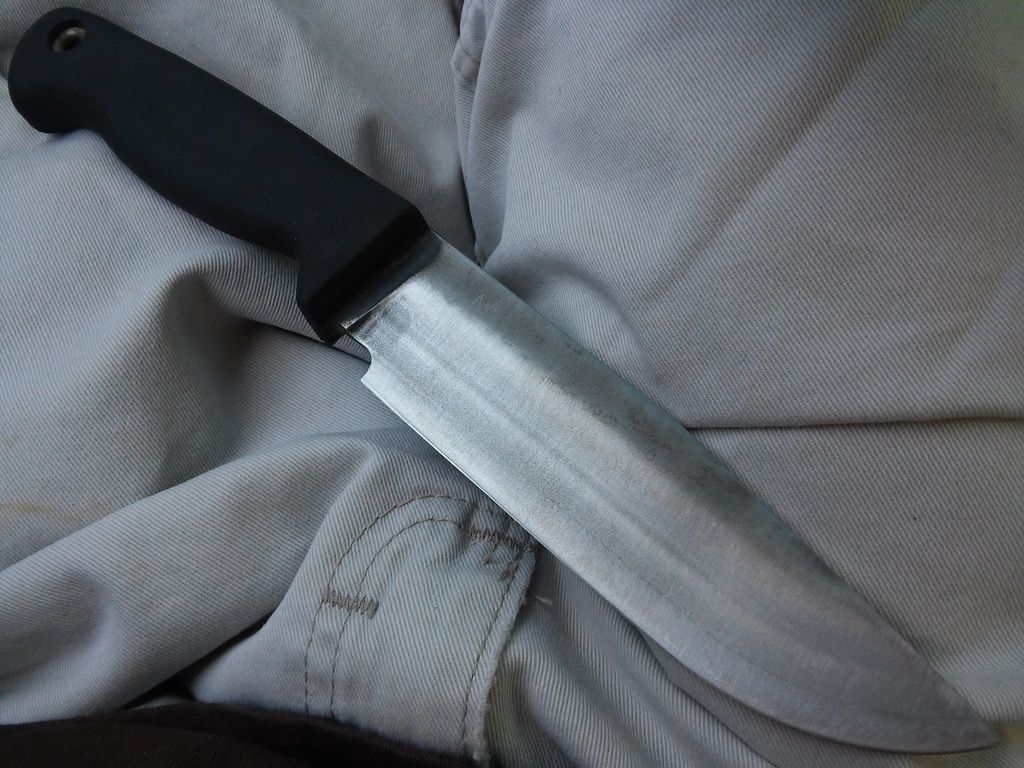

I collected two blocks of sandstone in the desert recently for experimentation with sharpening/regrinding my Scrap Yard 511. One was similar in size to a bench stone, the other smaller so it can be used in hand as a file. In order to achieve a perfectly flat grinding surface, I used the flattest surface of each rock to grind against one another with a small amount of water added as a cutting fluid.
I used the smaller piece in hand as a file after soaking with water to regrind the primary bevel my SYKCO 511. The larger piece worked well as a bench stone in the traditional way you would use a waterstone, working the secondary bevel in a back and forth motion until the apex had been cleanly formed, then stropped backwards to eliminate any burrs that may have formed.
The finish that is left when keeping the scratches in a uniform straight line from edge to spine has a subtle dull satin appearance. It actually cuts quite fast with SR-101 at 58-60 RC when the surface is kept wet to moist in order to create a thick mud on the surface that flows well when kept sufficiently saturated with water.
Pics added below..... :)

Here's what it looked like while I was regrinding the primary bevel, lots of thick mud ..... :thumbup:
Here's the result as of right now.....
As you can see, the primary grind has been blended into the secondary (edge) and convexed into a single blended bevel. This convex shape is due in part to changing grinding angle during the process, also the stone I was grinding became concave as it wore down and dished. I used pretty firm pressure with stone in hand for this, you could really hear how aggressively the sand was cutting.
I started regrinding this knife with an extra coarse DMT diamond stone, which was much slower grinding in my opinion than this method using sandstone and firm pressure. I do believe the 511 came factoy with a very slightly convex primary saber grind also (1 degree off flat) so it wasn't perfectly flat to begin with. I will likely continue regrinding to blend the primary up to the spine to make it full convex.
