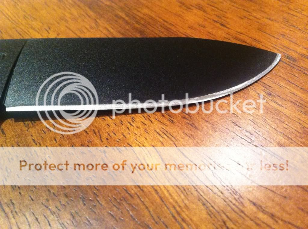

Ok. So I am super frustrated with hand sharpening. I can get my bk11 sharp enough to cut paper easily but I can't get it shaving sharp. I am using a smith fine/course interrupted diamond stone. The one that's around 15 bucks. Is it just that I need more practice? Or better tools? Or both?
Here are some pics if it helps.
Have you tried shading the bevel with a sharpie to make sure that your working at a consistent angle. I know that trick really helped me out. :)
looks to me like you adding a micro bevel to your microbevel, soldmyhat. What technique are you using? for example do you sharpen on one side, raise a burr, then take the burr off by sharpening the other side? or do you do even amount of passes on each side back and forth one side at a time?
I tried the marker thing and I took it off in one pass. With my sharpener I can only hold it one handed. That might be holding me back. Maybe. Maybe not. I will keep tryin though. Can you actually see the burr? And how many passes should that take? I have tried many on one side then on the other and going side to side too. All results were about the same. Paper sharp but not shaving sharp. Am I going at too low of an angle?
Are you stropping it? I can't get it to shave until I do that... but if you've looked around the forums you'll see that if you start asking about shaving sharp you're gonna open a huge can of worms about a lot of things that might go right the eff over your head. That's what happened to me! As for holding it one-handed, I might be in the minority, but especially with my smaller blades I actually get better results doing it that way. One handed allows me to tilt the stone down and that allows me more control over the angle. When I try it with the stone flat I often find myself catching on the edges of holes on my DMT stone that are meant to catch the slurry/metal filings. Oh and yeah -- are you using water on your stone? That helps too.
And if I'm full of it, please, someone say so! I'm a noob too, but I've successfully removed most of the hair on my left arm in the past few weeks based on what I've learned here ;)
In my humble experience, something less aggressive than diamonds works best for finishing a carbon steel blade. It's hard to polish off the burr without creating a new one on something like a fine diamond. Try looking at your edge with a little magnification. Also make sure your final passes on the stone are feather light, almost no pressure. I like to use spyderco's ceramic bench stones, but something like an inexpensive crock stick can put killer edge on carbon steel.
