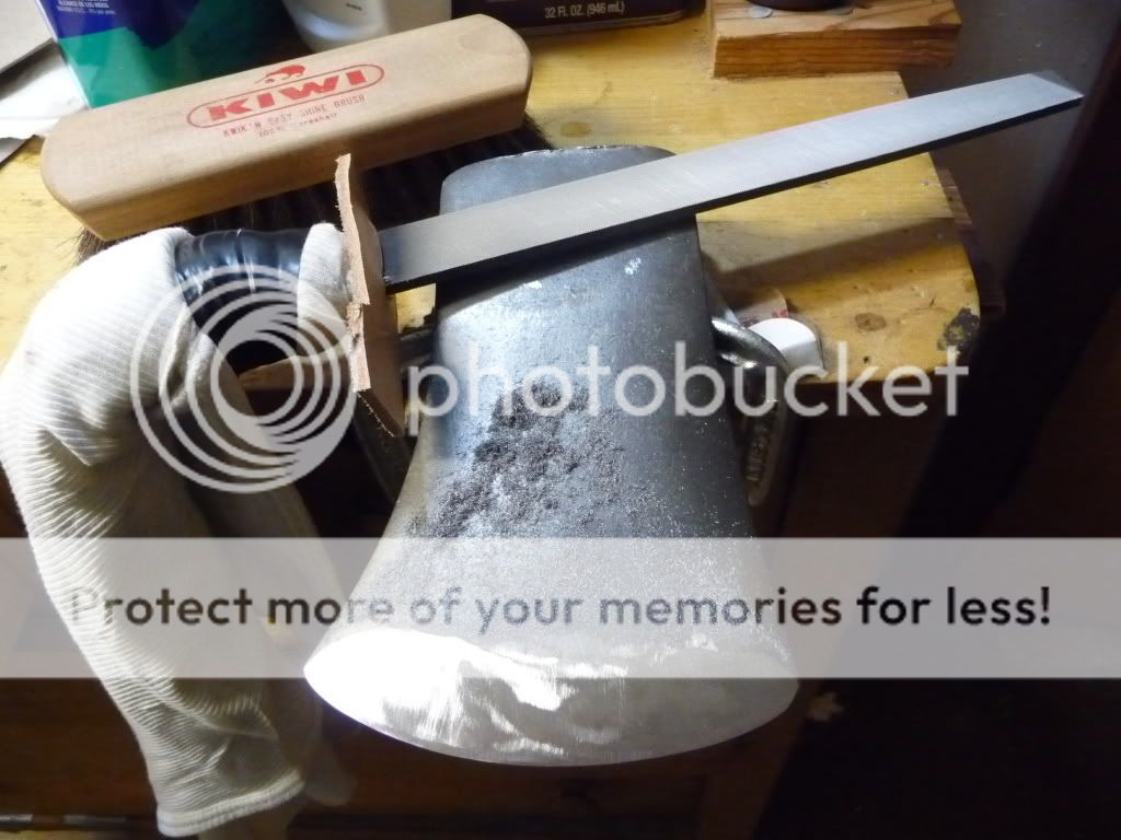

In its current state, does the edge slice paper and lightly bite into the back of your fingernail? If not, the edge probably hasn't been established well enough and you'll want to start over, making sure to establish a NOTICEABLE burr with your file (like below) before moving on your puck/stone:
If it DOES slice paper and passes the fingernail test, then it's probably just too steep a final edge angle. Any edge that's 45 degrees or more (total) with a lot of metal behind it isn't going to shave hair. Most store-bought axes are going to have a very thick, very angled edge. If you simply try to refine that edge without first reprofiling and removing a lot of material, you're just going to make a blunt tool shinier rather than sharper. That said, if you already did reprofile the axe to something around 30-40 degrees total then it might be that the mousepad is rounding the edge you established like m3mphis said. A properly profiled axe should be able to shave arm hair -albeit with a lot of tugging- after you knock the burr off with the fine side (I believe that's 280 grit?) of a lansky puck and stropping on a leather belt...
