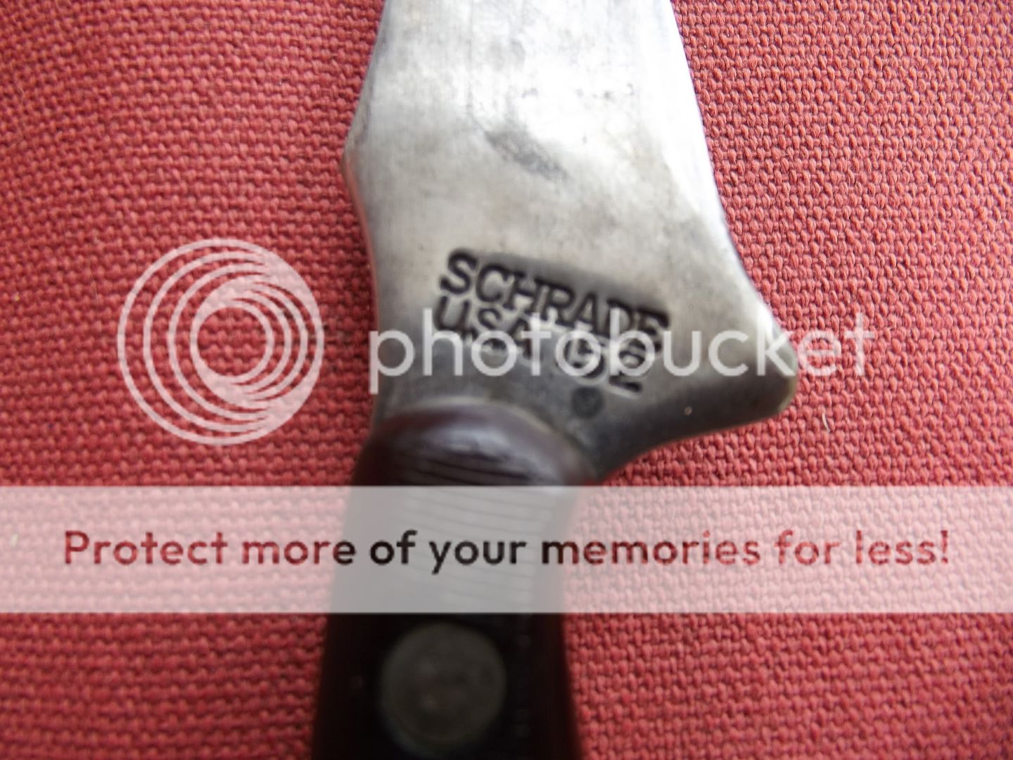

Gentleman....I have notived the stamp on my sharpfinger is slightly different to one posted on the hunting forum..the #1 (152)is to the left of the A (schrade) that is directly above it...on the other knife the #1 is directly in the centre of the A...obviously a different stamp??..and would this stamp difference determine its date of (broad) manufacture???....with thanks ....FES
This is the stamp as it first appeared in 1974 with a full serrif "1". I see these on brown boxed knives.
This is how it was stamped circa mid 1980's with a non-serrif "l". I see these mostly on tan "sharp idea" boxed and clampacked knives.
Sometime in the late eighties to early nineties, it changed to a top serrif only. I see these mostly in the blue boxed and clampacked and last diamond plate boxed and clampacked knives.
I cannot give exact years for these tangstamp changes, only the rough order in which they appeared.

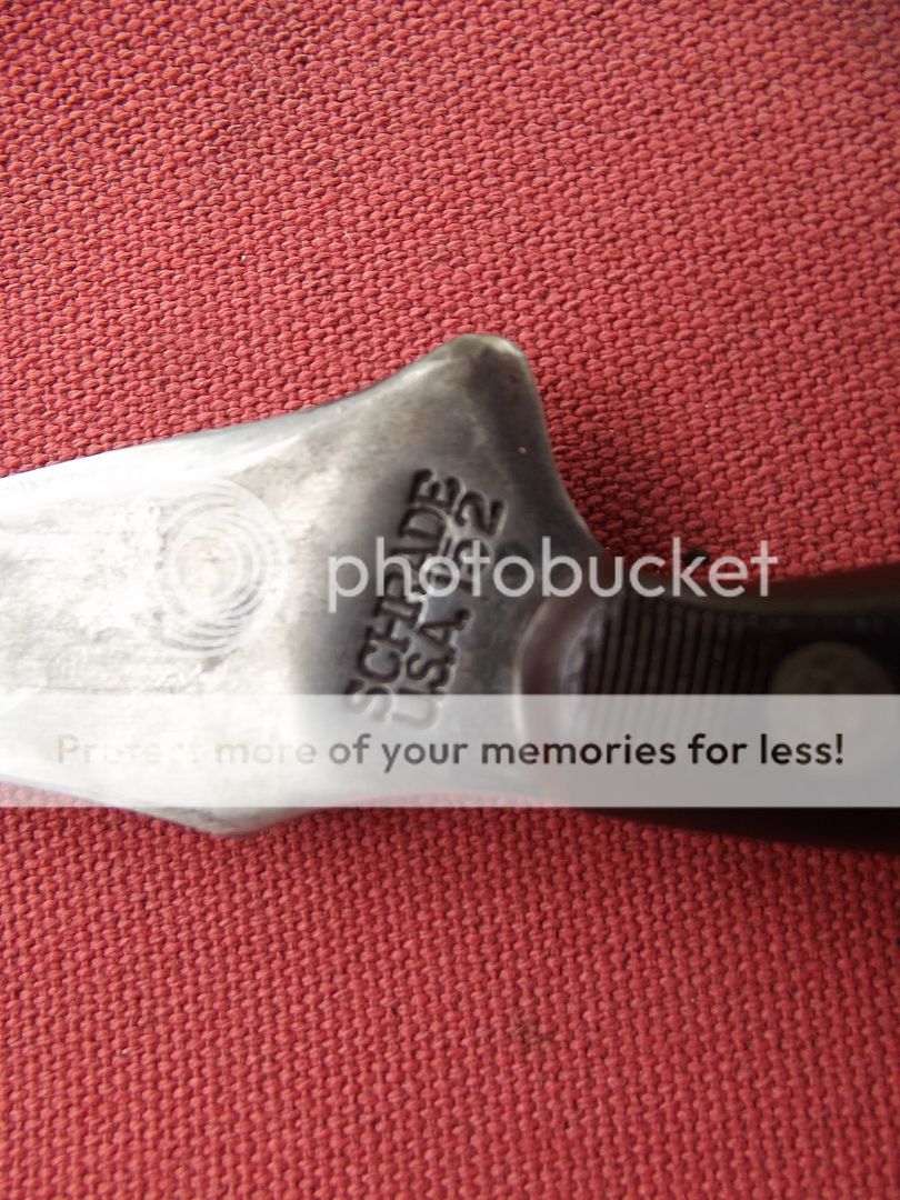

For reference, here is a second stamp that is very worn. Note the weak strokes of some letters and broad, flattened strokes of others. Also, note how deeply the tang was struck in order to get the weak strokes to show at all. This die was overdue for replacement, IMHO.
