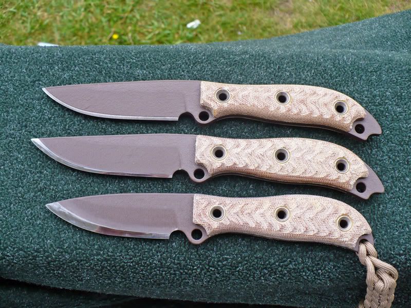

I've had my Edge Pro Apex for just over a week now, and I'll vouch for the EP/SM combo as being the way to go. The Edge Pro rocks for rapid material removal, and can then take your bevel up to a mirror finish. Once you reprofile to (say) 25 degrees or so, you can sharpen for a long time with the Sharpmaker at 30 degrees before you have to break out the EdgePro again.
So far I've done a pretty serious reprofile job on a Busse Active Duty, and a less extreme job on a Meaner Street and a Benchmade Nimravus. At the risk of repeating photos I've posted elsewhere, here's a shot of the Busses. (Original bevel on top, reprofiled in middle and bottom)

A million thanks for the info and photos. That's a great source of advice as I really would like to re-profile my CKRT M16-13M and maybe even my ZDP-189 Leek to a single-sided bevel (forget the name of it...).
