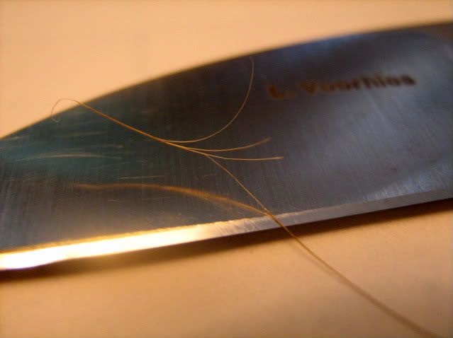

Aligner, benchstones up to XXF and CPM-D2 before stropping. With the tools you have your knives should be this sharp.

Just sharpened my Izula (again) and huzzah! Great Success! I guess I never stopped to check the edge before switching to the next stone. Went down from coarse to XXF checking for a burr and if I found one, did a few more strokes. After finishing the fine stone I tried shaving a bit of hair and it cleared a patch in a couple of lstrokes! After I got done with the XXF it was plowing the field with one light stroke :cool: Took about 45 minutes to walk it through the 4 stones but it was worth it :)
