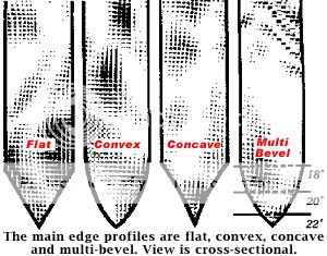

grind: the form/the way in which the different sides of the blade are (convex, chisel, flat, hollow, scandi etc)

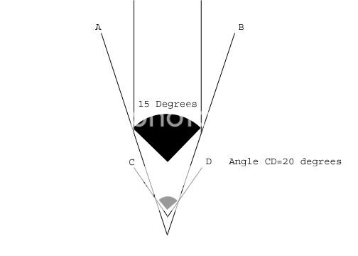

bevel: the final shape of the edge where the left side comes together with the right side of the blade (the V shape that makes the edge sharp, a hard V or a rounded off V (convex) )
microbevel: a small bevel (micro) that sits on top of the bevel and has the edges come together (optional)
I found some pics for you, let me know if this helps. I personally do not like doing a micro bevel because your taking steel away above the edge though its not much, but I still dont like doing it. The times I have used a micro bevel, it made it tougher to re-sharpen. It takes a little longer to sharpen with the striaght 40 degrees but I feel it gives you a tougher edge. Let me know if the pics help ?
Pics definitely helped! Thanks! I also found a lot of great info at http://www.jayfishercom
So is the microbevel, another set of angles, right above the very tip of the edge? So basically if you had a flatground blade, the microbevel would be another tiny set of angles right before the the two side of the blade meet for the edge?
