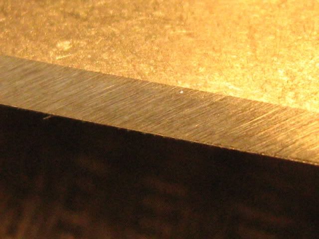

1) Don't worry about counting strokes, each knife is different and will need to be profiled to match the SM angles.
2) Work with the coarse diamond rods until each bevel has a even scratch pattern and the edge is sharp.
Like this.
Once the bevel has a evenly profiled edge that is sharp you can then move to the brown ceramics. Starting with a medium pressure work each bevel until the scratch pattern from the diamond rods has been removed and replaced by that of the brown ceramics.
The progression should look something like this. (this is a 1200 diamond stone, similar to the brown rods)
At the ending strokes you want to lighten up pressure and work to remove the burr at the edge. Each grit will produce a burr and it will help you greatly to try and remove it as much as possible at the finishing of each stone before moving to the next.
You will probably be fine with a single setting of 15/30 from start (diamond) to finish (fine ceramic). When using the blades you find that the edge is becoming too damaged a microbevel with the fine rods in the 20/40 setting will increase edge retention and resistance to deformation.
