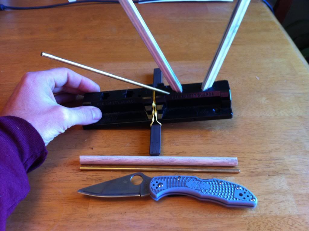

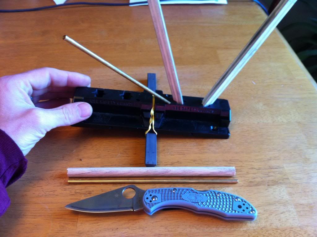

You can change angles like this. Using different sized dowels can yield different angles. You can download an angle finder app for your smartphone to check the angles. It takes a little getting used to rocking it back and forth when switching sides but when reprofiling I will just do a bunch of passes per side (like 20, 50, 100, whatever it takes) until I get closer to apexing. You can get pretty efficient doing like 5 passes per side and then rocking the base to switch sides. You just have to do it and establish a little muscle memory and rocking the base just becomes part of the process. There is a perfect little slot in the top of the base for the rubber band to sit in so it stays centered well.

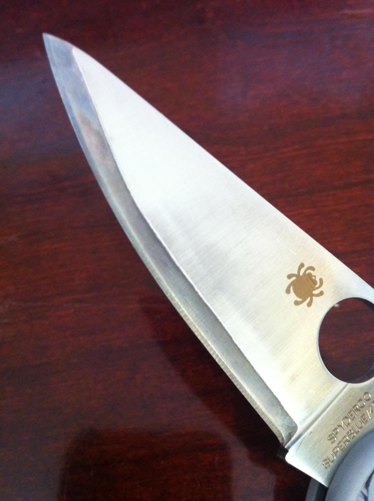

I took my Super Blue Delica from this...

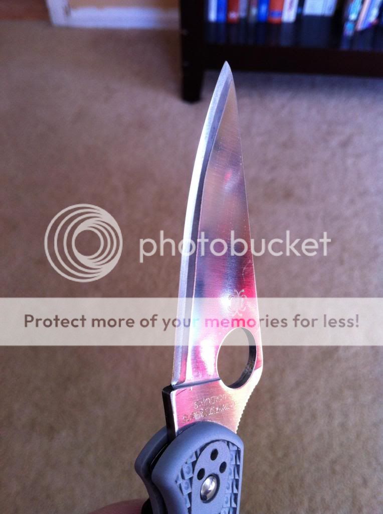

... to this...

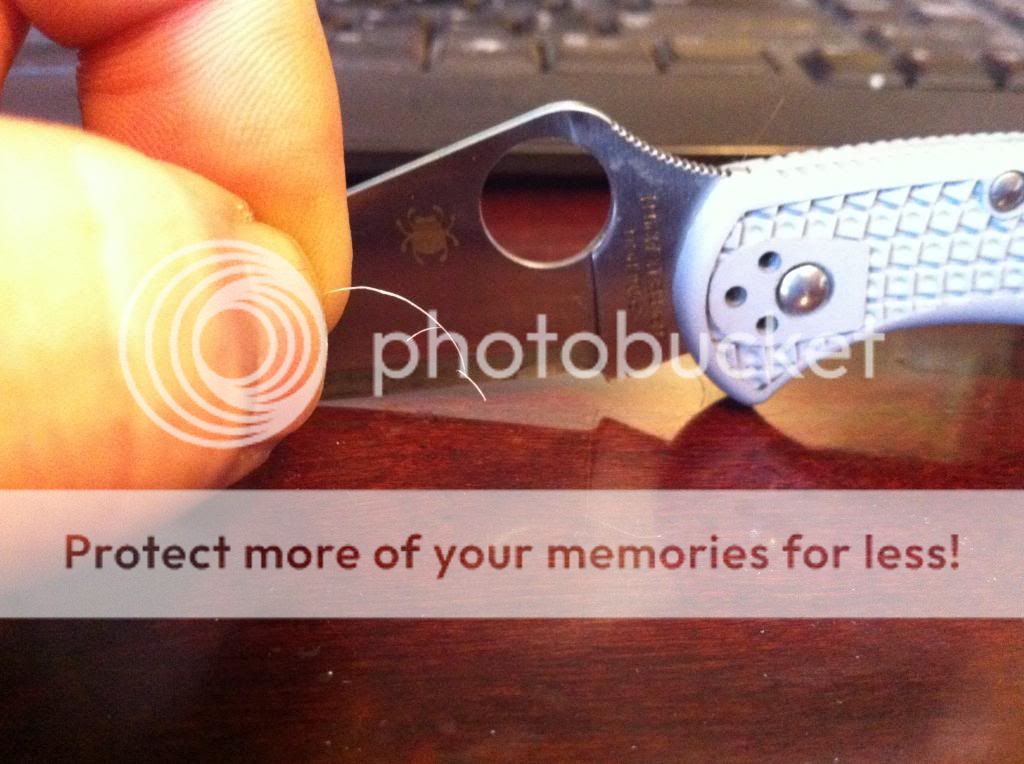

...and it will do this to a very unneeded white beard hair.
